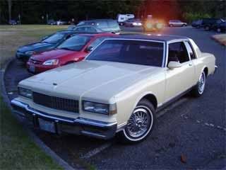

I want to build a box for 1 12" that fits in the upper deck area of the trunk off to the left side of my '87 Caprice. Anybody got any good pics of their trunk speaker set up? Maybe somebody's done this and has measurements?

hello there,that is a nice picture of your 87. would you by any chance be thinking about selling it in the near future? i am very interested!!!
