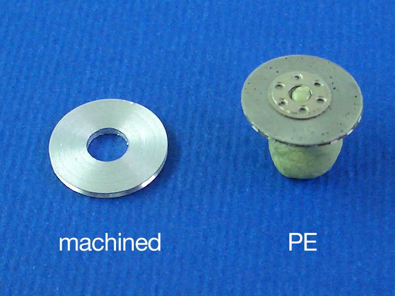

the ultimate (pre-die) stuff:
http://i27.photobucket.com/albums/c159/gionc/CIMG5749.jpg
http://i27.photobucket.com/albums/c159/gionc/CIMG5751.jpg
They aren't just a lip like in my S7 but a whole rim turned outside, inside and in both front and back side, first time I do it.

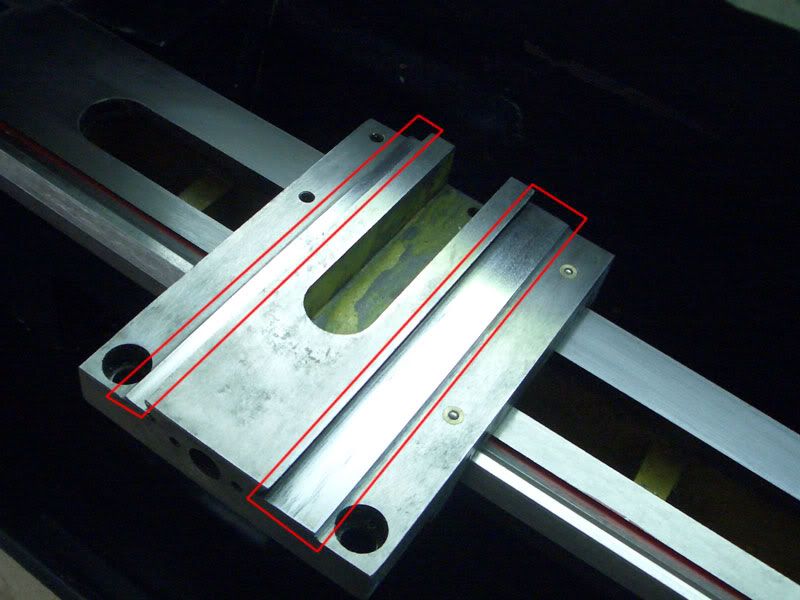

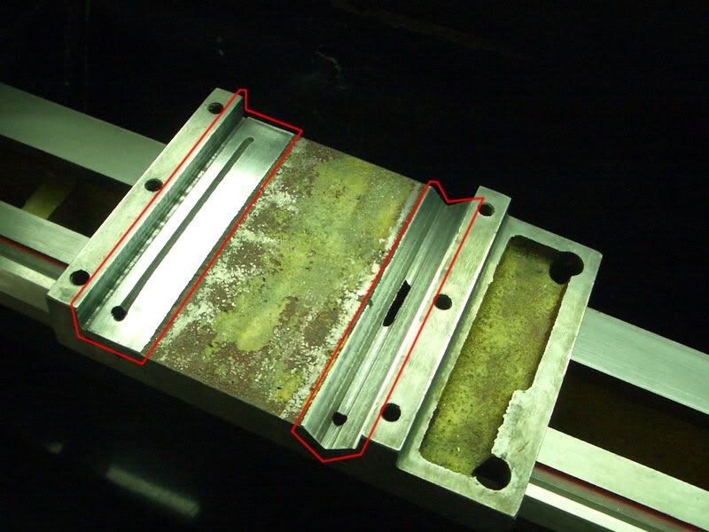

The cross slide: degreased and cleand, before add grease (BTW I found nothing done from teh factory..) I lapped a bit sliding surfaces (outlined): the sliding is better now and I haven't lubricated jet...

I guess you're right Thesaint: those Hornet stuff is exactly the same.... great price you found: I paid 500 (naked, no tools etc.) as alimited offer (but not delivery exp. luckily ;) ) , now it cost more.

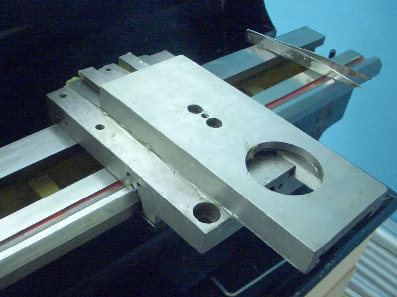

The first trouble: is not so easy set the play behind the cross-slide and the rails: simply you can't access to the "setup screws" with the slide on the rails: the only way I found is adjust better than you can and mount it on the rails: after some attempts I have ever a bit of play (or I can't move-mount).... hoping it wouldn't do mess in drilling operations...

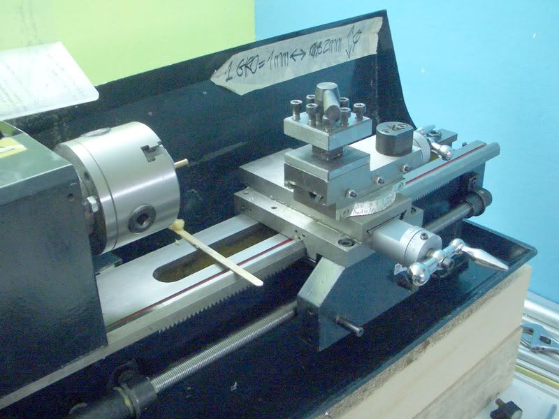

Well guys: this is what we call "fitting test"
http://i27.photobucket.com/albums/c159/gionc/machining/CIMG5760.jpg
(dunno used tack or white glue BTW LOL) all is clean WD40nted (away from the workbench ;) ) and greased now, and at least I haven't screws left: this is jet a good result LOL, now let me play with gib screws ;)

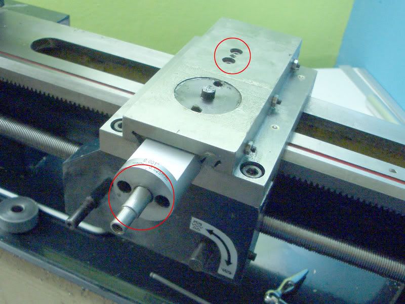

I'm an a$$hole: the solution wasn't so hard to find: you need just to remove the back panel.

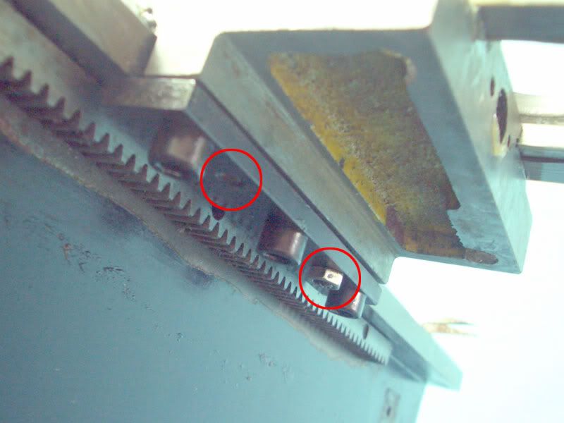

PS: re-building the cross slide pay attention there: I lost some time trying to adjust the brass cube height becose I used wrong screws, in fact stroked screws have the same thread but the cranck one are longer!!!!! Don't make the mess I done ;)

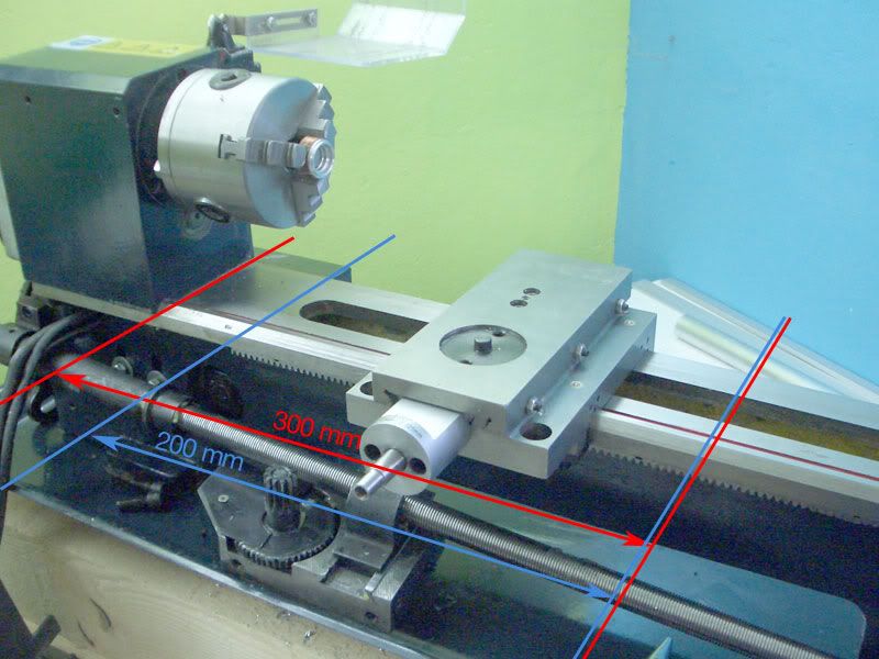

I realized that in my lathe is impossible to set at minimum the play between the cross slide and the rails on the whole rail's length: insthead to find an average set up I opted for a fine setting for the first 300mm, so I have 200 working mm with a perfect sliding and no play (before the re build I had a lot, note that I found unscrewed all screws...), anyway I guess I need to check this set up off and on...

The job is done and I'm quite pleased, first I have yet the lathe (I wasn't so sure when I seen all the spare pieces) but more it's much better now: removing plays allow to achieve a fine job and I have less vibrations too... anyway at least the impression is those of a better stuff.

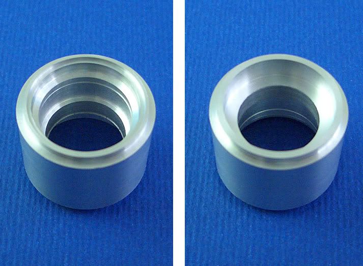

First hot parts on the desktop: I think I'll achieve a better finishing now with less plays and vibrations, and enjoy the job a lot more. Thanks guys for comments and helps you offered.
Renault Alpine 442B rim, machined in all 4 sides: outside, inside, front and back

A disc, near the ventilated PEtched one (don't care about the rough surface, was the first time I etched something thick and I have already a 0.1mm disc to glue on)
