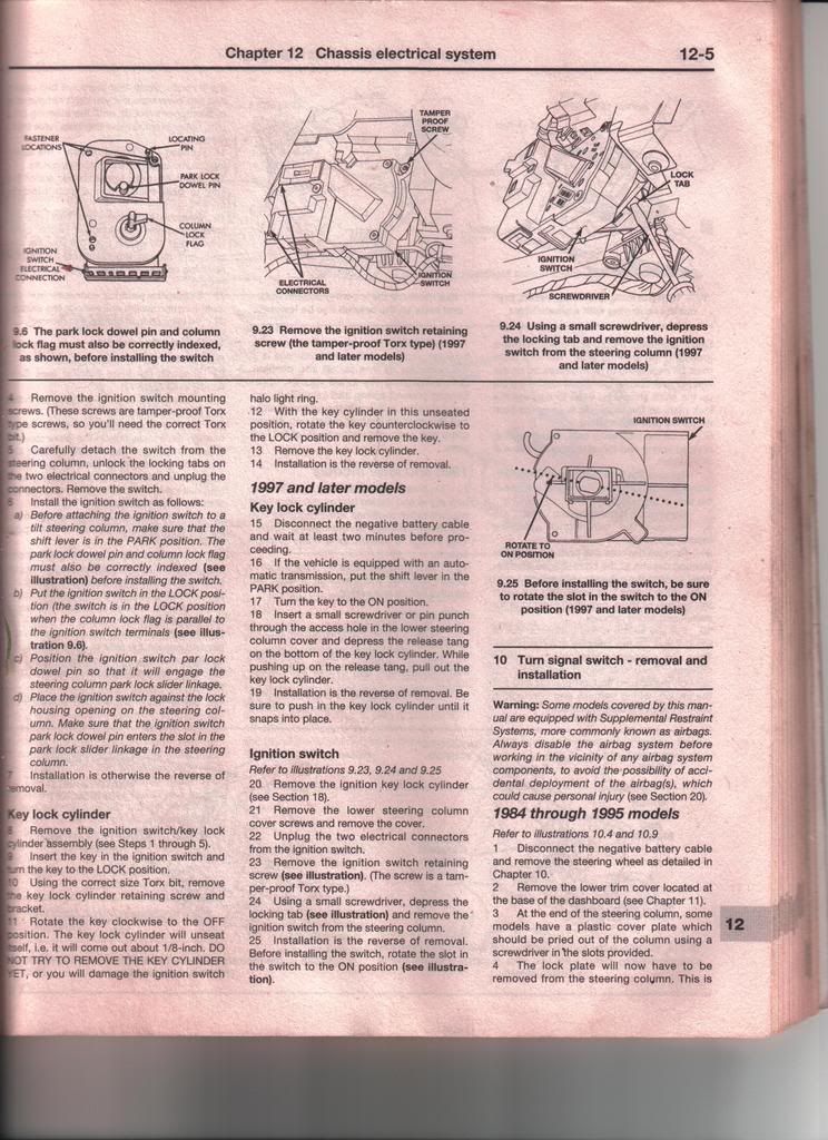

http://i179.photobucket.com/albums/w293/93civicgsrt/ignitionswitch001.jpg I scanned the page were the ignition switch is. I tried to chop down the size but it couldn't.
Anyways see the ignition switch pic (top left) it seems that it controls the wheel lock too. Tell me what you think.

Update. Yes it was the cylinder lock. Jeep dealer keep the same key I had. Thanks for the help.
