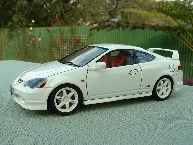

how do you do this...
http://www.automotiveforums.com/scalemodeling/pman/itr2x2.jpg
i'm guessing i should use some kind of gumdam robot marking pen. if so what kind should i use? (brand name, size, etc.)

Try to find a Gundam Marker; a fine tipped marker for those Mechs also used for panel line detailing on model cars. They can be found at www.hlj.com :)

Or you can thin down black paint and put little blobs along the panel lines and the paint fills the lines itself. The little blobs left on the body can be polished out.

Another method for panel lines is to use artist's acrylic gouache paint. This stuff is available in some form or another at all artist supply shops.
Just paint a generous amount in the panel line, then wipe over with a tissue, cotton bud or whatever is handy. The paint will remain in the engraved detail and be removed from the surface.
As the paint is water based, if you screw up it is easy to remove and try again. And unlike markers you can mix whatever colour you like, i.e. a light grey line where full black might appear too stark.

Is the paint thick? because with it being water based, couldn't you just thin it down a bit?

Yeah, straight from the tube the gouache is pretty thick, so it is very easy to brush into the panel lines. It can be watered down to thin consistency for washes in wheels etc.
