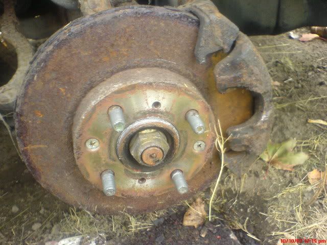

Easy enough. If theres something (rust, grease, road debris, etc...) between the rotor and the wheel hub, it could put your wheel at an angle when you bolt it on and cause it to vibrate.
The brakes on my car...
http://i147.photobucket.com/albums/r300/modelfreakca/DSC08089.jpg
Yes those are ACTUALY the brakes on my car.
No the thing ain't street legal.
Yes I do drive it around.
FrodoGT
10-27-2007, 03:12 PM
Those look like artifacts dug up from some indian burial mound dude..damn. They dont even have a distinct shape anymore. Especially the caliper.
Christ
10-27-2007, 10:29 PM
EDIT... those are the "lack" of brakes on your car... no pads, no brakes bro... do you stop it w/ the e-brake or something?
I did that for awhile when one of my lines broke on my old azz sunbird... stopped w/ the e-brake and downshifting... made for a fun time when someone stopped quick in front of you.
Nick Gautreau
10-27-2007, 11:11 PM
yup... use ebrake
i just crank it as hard as i can... oddly doesn't lock... its like ABS on handbrakes. (stops fast too, so I know their not worn)
Christ
10-27-2007, 11:17 PM
rofl... it's pry stretched or something.. so you may be reaching the end of the e-brake travel before the brakes can lock.. but hey, if it works, use it :P
Nick Gautreau
10-27-2007, 11:22 PM
no I can feel the tension and the handle only goes about 3/4 of the travel it's supposed to have.
I checked the rear pads the other day... they were about half an inch thick, but the drum is totaly shot... rusted to hell (rust actualy ADDED thickness to the drum.)
Christ
10-27-2007, 11:27 PM
that might be why they won't lock too.. the rust might be breaking off and "rolling" between the pads and the drums.
Nick Gautreau
10-28-2007, 01:40 AM
that might be. Although that doesn't explain the Xtreme stoping power it has! It literaly push me into the belt and tilts my head forward... that's how strong it is!
Christ
10-28-2007, 11:19 AM
again, could be that the rust is causing enough friction to stop you at a glance, but not enough to lock. BTW, nice sig ;)
