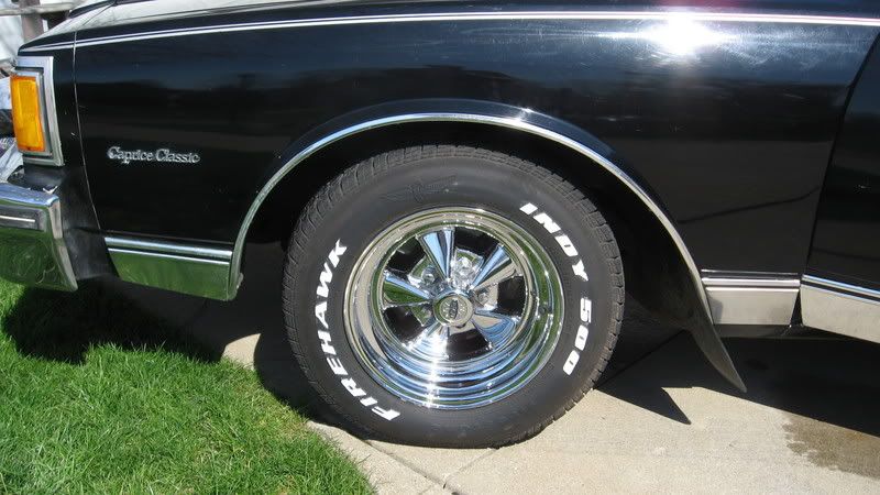

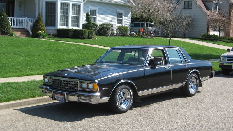

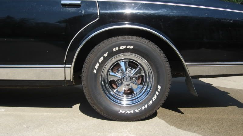

'83 Caprice Classic with Indy 500
Cragar S/S - 15" x 8" all around
235/60 up front, 275/60 rear
http://i27.photobucket.com/albums/c157/sickspics/83%20Caprice/IMG_0785.jpg
http://i27.photobucket.com/albums/c157/sickspics/83%20Caprice/IMG_0787.jpg
http://i27.photobucket.com/albums/c157/sickspics/83%20Caprice/IMG_0790.jpg
http://i27.photobucket.com/albums/c157/sickspics/83%20Caprice/IMG_0794.jpg
We bought the Indy 500 as we wanted a different look from the BFGs you see everywhere. However, I would not buy them again. We've had very poor tread wear and lots of 'chips' of rubber coming out of the tread on a couple of the tires. My tire guy has many years experience and believed it was a manufacturing defect but Firestone would not replace them.
I did find out when buying them that you don't get usually get very good wear out of the big meats nor good traction compared to a narrower tire.
But hey...ya gotta look cool!
