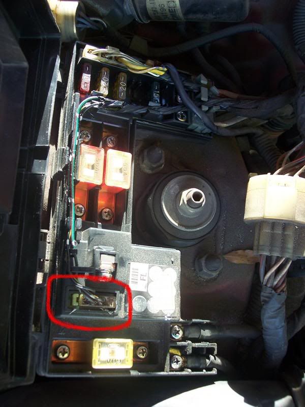

Now two things that have me puzzled:
#1 - I went through the fuse box in the engine compartment checking for power. All of the wires were pulling power in the 'On' position except these three circled in the picture below:
http://i59.photobucket.com/albums/g303/jimmym86/100_4820123.jpg
***I had the ECU Fuse removed to test for continuity, incase anyone notices.
Are these supposed to to drawing power?
#2 - I tested where the ECU fuse sits for continuity (with the Ignition Switch 'On' and I was NOT getting continuity there (which might be part of the problem).
I'm hoping someone might notice something I overmissed. I think at this point I can tell it is nothing major, but more likely something small and stupid I've overlooked. Any help would be greatly appreciated!

Does anyone happen to know if the two wires coming from the connector in the picture above should have continuous power or how much they should be pulling in the 'On' position?
The two in question are Black/Yellow and Green/Red...I tested again and they have no power in the 'Off' position, but in the 'On' position they are pulling very very little power (.08) compared to the others (12+) in the fuse box.
I've seen the Black/Yellow wire show up in the Ignition Switch as well as the Main Relay. So depending on how much juice they should be pulling, it may be part of the problem...

im having same problems, did you figure it out yet. That connector i think is just a central connection point for all wires going to the main relay to power the fuel pump side, I am going to check mine out tomorrow, hopefully i find the problem. I will let you know.
