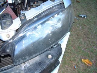

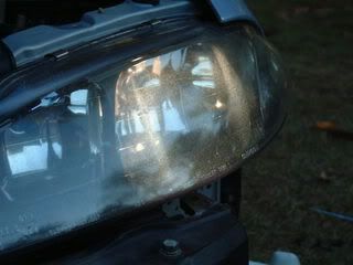

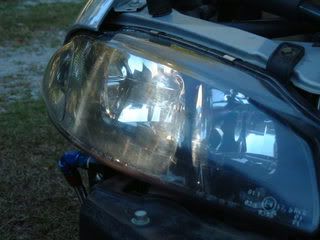

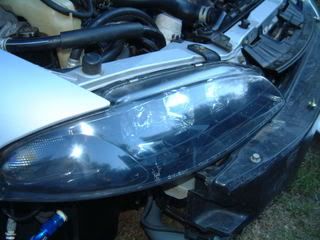

So I finally got tired of looking at those nasty yellow headlights. Some of you may remember my idea of putting a coat of clear over them but I just didn't have the time to do it when I go home. I am very pleased with the way they turned out.
http://i189.photobucket.com/albums/z173/SilvrEclipse/DSCF2390.jpg http://i189.photobucket.com/albums/z173/SilvrEclipse/DSCF2392.jpg
http://i189.photobucket.com/albums/z173/SilvrEclipse/DSCF2395.jpg http://i189.photobucket.com/albums/z173/SilvrEclipse/DSCF2396.jpg
l_eclipse_l
10-11-2007, 07:59 PM
It looks like the pictures on the left are the after pics? Hard to say because of the lighting though. The bottom left pic looks good.
SilvrEclipse
10-11-2007, 08:10 PM
Yea the ones on the left are the after. You can kinda see how bad they were on the top right pic. Should have done this a long time ago. I think it took around 4-5 hours to do the whole thing. There is no way to get the lights out with the bumper on.

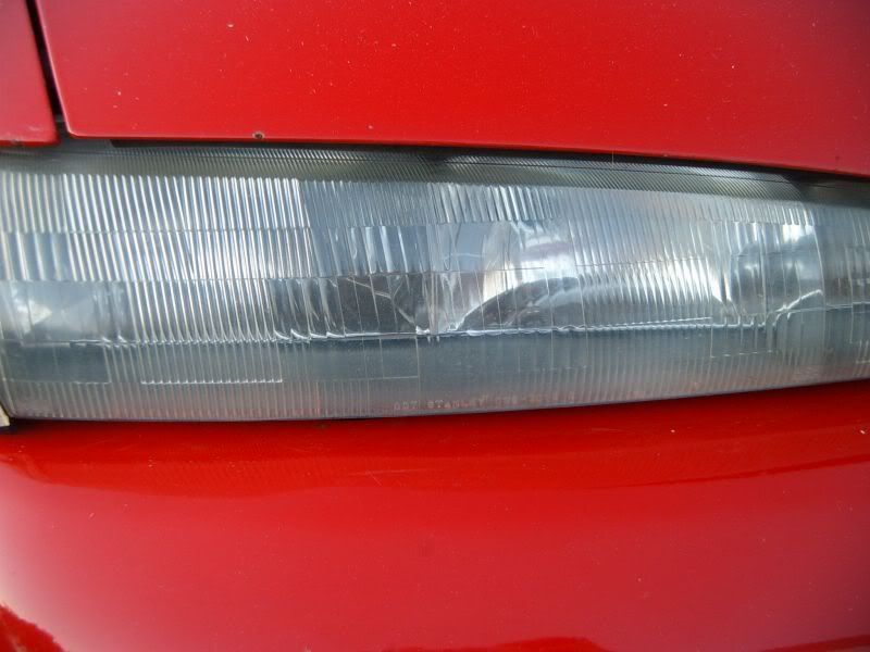

Well I wanted to see if it really worked so i half assed it on the talon for about 10 minutes with 1000 grit and then polished it up. Sometime this week ill buy me some 2000 grit and give it another shot. Heres what I got so far.
http://i143.photobucket.com/albums/r149/badeclipse/lightbefore.jpg
http://i143.photobucket.com/albums/r149/badeclipse/lightafter.jpg
