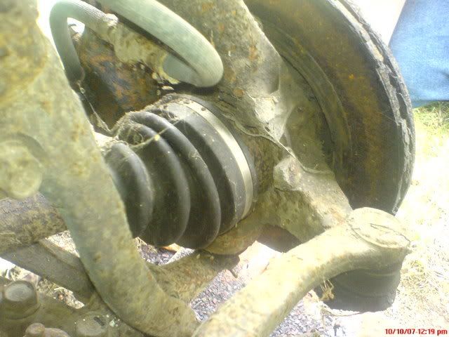

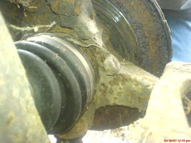

I've got a serious rust problem on my 1990 Civic DX. The car has been parked in the grass for a couple years and the brakes and spindle (I think) are rusted to everything else. I got the the rear brakes free turning, and the front callipers loose enough to take the pads out, and also got the out the bolt that connects the line to the calliper. That's about as far as i can go. Everything else is rusted. I can't even remove the calliper bolts to change them!:shakehead
Helpfull tips anyone?
This car is REALLY not ready for the road, so new brakes are not in order yet. I just want it free so I can move the car under it's own power to the parking lot next door.
http://i147.photobucket.com/albums/r300/modelfreakca/phpGPwjqAPM.png
Pics are up. Be warned. It is not pretty!!!!!! :frown::uhoh::shakehead:eek: *gasp*
...AND I forgot to mention yet again, the other side is exactly the same.
http://i147.photobucket.com/albums/r300/modelfreakca/DSC08089.jpg
http://i147.photobucket.com/albums/r300/modelfreakca/DSC08092.jpg
http://i147.photobucket.com/albums/r300/modelfreakca/DSC08093.jpg
FrodoGT
10-10-2007, 12:30 AM
Get the calipers off and replace them, its not worth the risk. Then since the rotors sound like they are obviously unsavable, beat the shit out of them to get em off (after you remove those fun little screw with an impact hammer). The rear drum SHOULD just come off after the wheel, but if mine dont, yours definitely dont. Again, beat it senseless with lots of penetrating oil. there is also an 8mm bolt hole in the drum on the face, you can thread a bolt into it and use it for prying leverage. Hop that helps.
Tony
10-10-2007, 06:30 AM
Those "fun little screws" are so simple to get out, just use an impact driver...one hit and they are out. You can pick up a cheap one at your local parts store for like $15-20. Put the right bit in it, and give it a good hit with a hammer, haven't had a rotor take more than one hit from it. When you put your new rotors in, you can forget about the screws because they have already served their purpose and you don't need them in there, your wheel, and caliper will hold the rotor in place.
As for the bolts holding the caliper, just get some penetrating oil and soak the shit out of them and hit it with an impact gun if you have access to one. If not, just try to use a big breaker bar(or cheater pipe) and keep popping it, not putting constant pressure on it.
Good luck.
