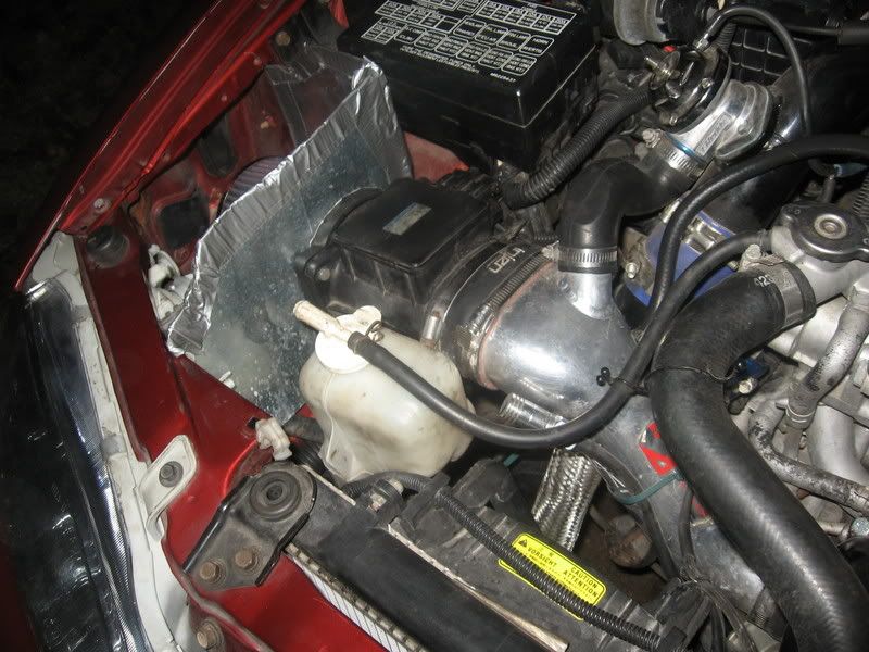

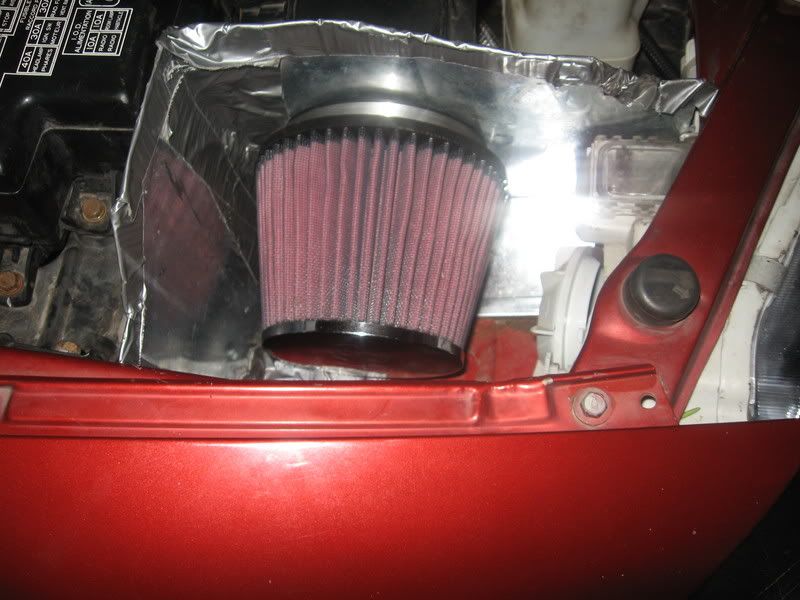

The INTAKE temperature is at the intake like literally right where your MAS reads. Its before the air gets past the IC. And as for the dam, I honestly believe its THE BEST DOLLAR PER HORSEPOWER mod you can do. I bought 3 dollars worth of aluminum sheeting and made the damn and it dropped my intake temps 30 degrees. Its a pretty amateur job but man it works awesome. Ill see if I can get a pic up for you thor.

http://i83.photobucket.com/albums/j294/steviekallday/Picture017.jpg
http://i83.photobucket.com/albums/j294/steviekallday/Picture016-1.jpg
Just take a cardboard piece out and a make a template and then use some tin snips and cut out your piece of metal. Keeps the heat from the engine completely out. !!!
Be careful the metal is REALLLY sharp thats why I used duct tape to protect against the edges.

The reason other peoples logs are higher at idle is because the heat gets trapped in and you suck some of it up but when you start moving the cool ambient air comes in from outside the car and as long as you have your intake dammed off your intake temps will drop right off.

steviek
10-07-2007, 11:12 PM
well all i know is my dam works really well as it is and the hood acts as the top. So I don't know how much it will really help. As for the rad fluid just add some water wetter and get the normal mix.

This is also why "cold air" setups on turbos are not worth it correct? I remember you touching on this earlier and I got into an arguement with one of my friends about it this summer but "Kevin said so" didnt back me up too well :p.
I like the info in this thread. I have a question though, dont those damns also help flow to the filter because once it gets there it doesnt have much elsewhere to go?
steviek
10-08-2007, 01:05 AM
Yea they do Especially if you take out your headlight !
