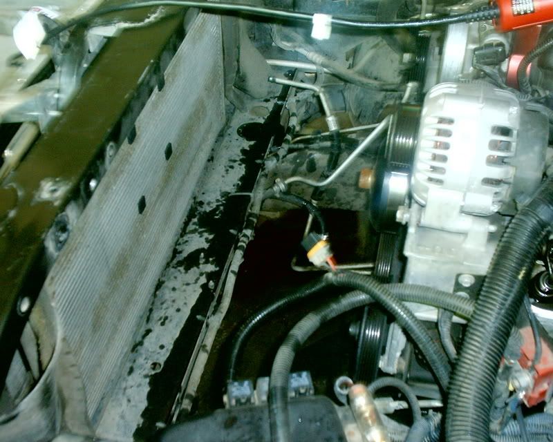

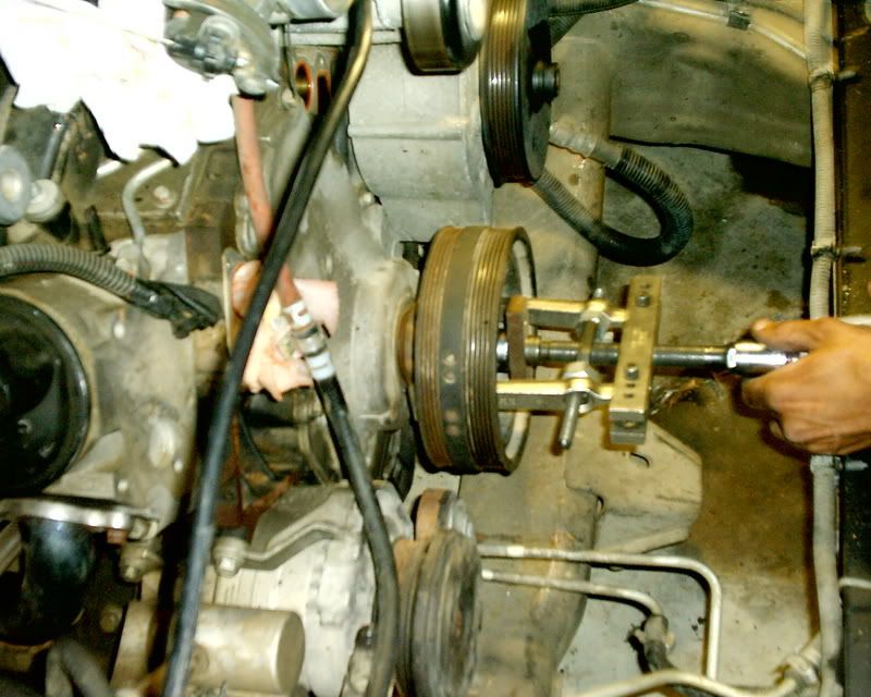

The engine has taken everything I've thrown at it without a hiccup. It still doesn't burn any oil, and there's zero noises in it. I honestly can't believe its taken the abuse being a stock internal engine. Here's a few pics from the cam swap(notice the puller we had to fab up because one of the inner tabs on the crank pulley broke off using a three arm puller
The puller doing its thing to the crank pulley.......

A good view of how much room you have when everything up front is gone
