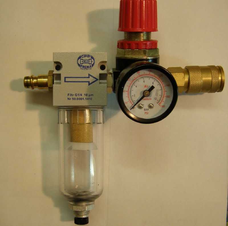

Anyway, to carry on down my own personal road to Hell paved with good intentions, I took some photos of my one.
http://i6.photobucket.com/albums/y247/klutz100/PARTS/filiter_01.jpg
I bought the regulator separately and it is just screwed together in line with regulator that was on the compressor teflon tape in the threads. I added a quick release widget as well.
The filter is made in Poland and cost in the region of 25-30$ IIRC. If you still have problems, it's no big deal to get one and send it to you - the shop is close by my home.

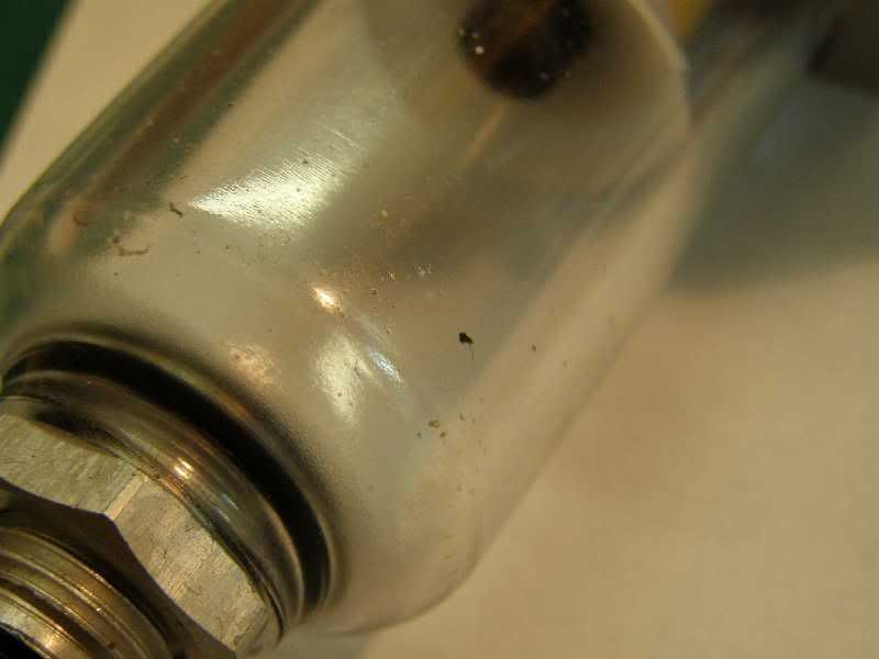

What really shook me when taking the photos was what has collected n there already with really quite limited use :eek: and I regularly drain the main airtank to avoid corrosion! Can you imagine if that crap had got on the model!?!?
