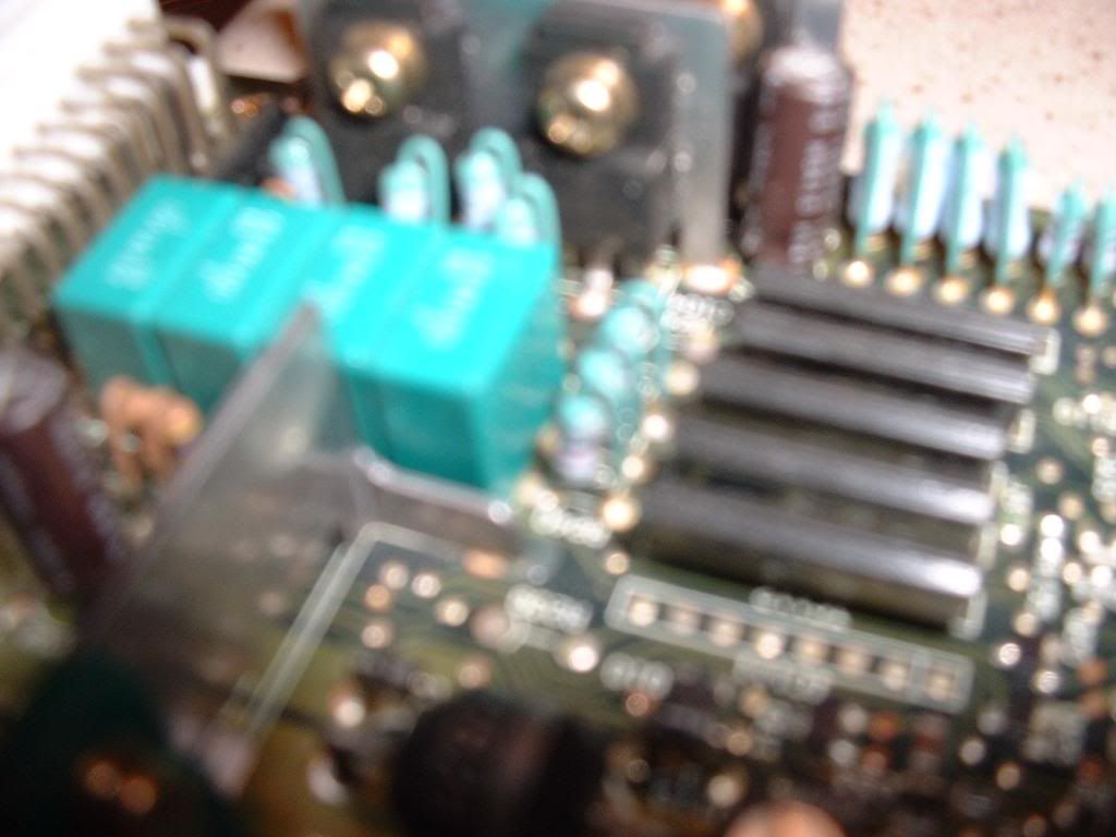

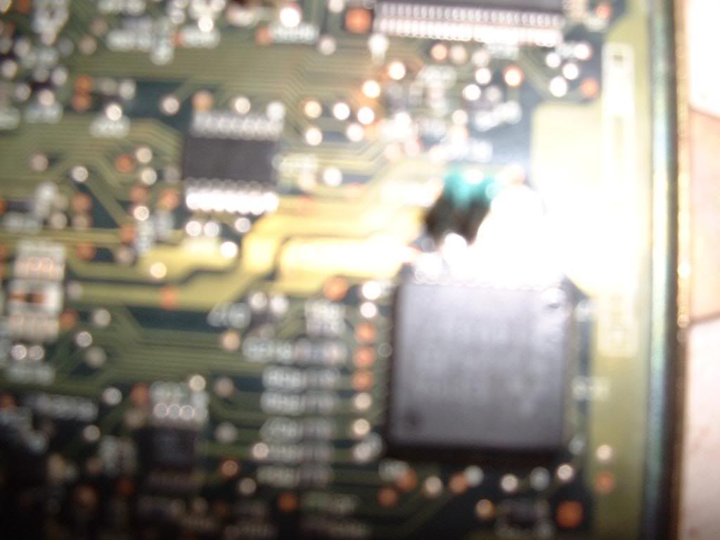

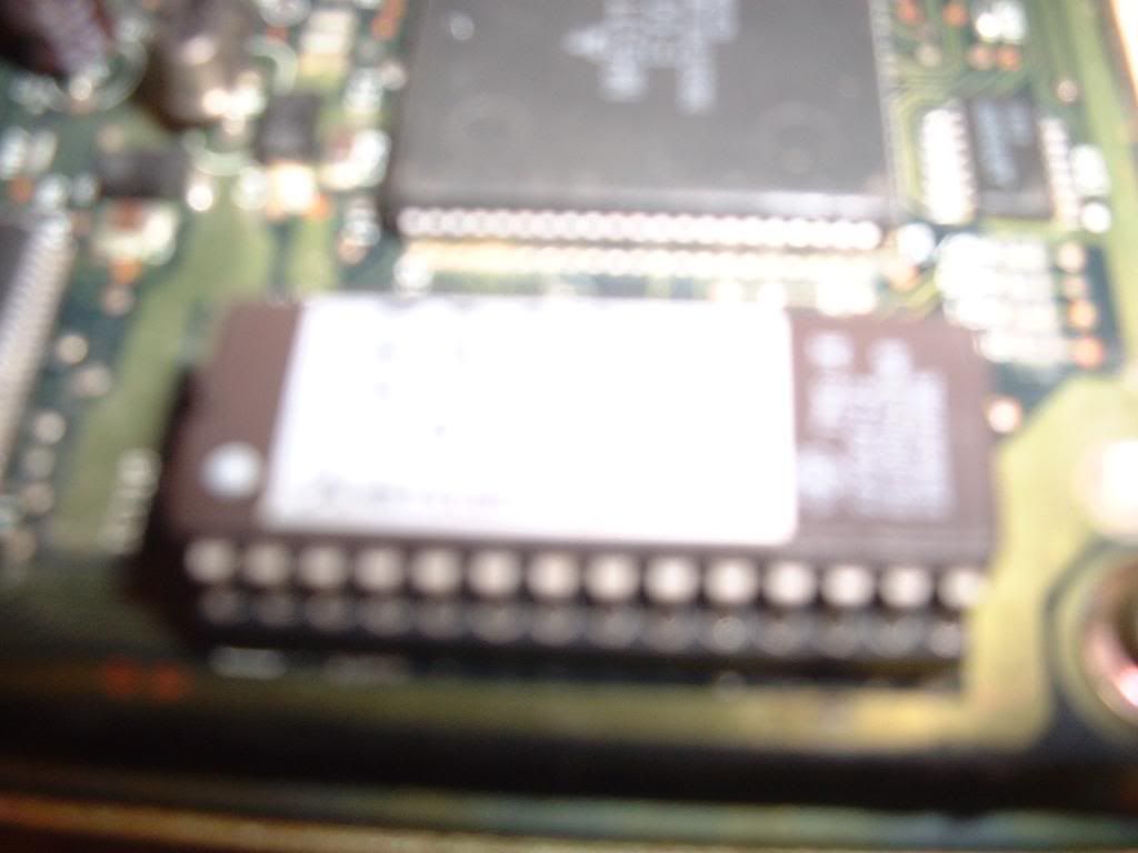

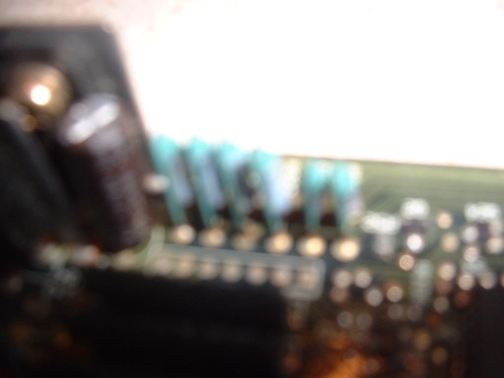

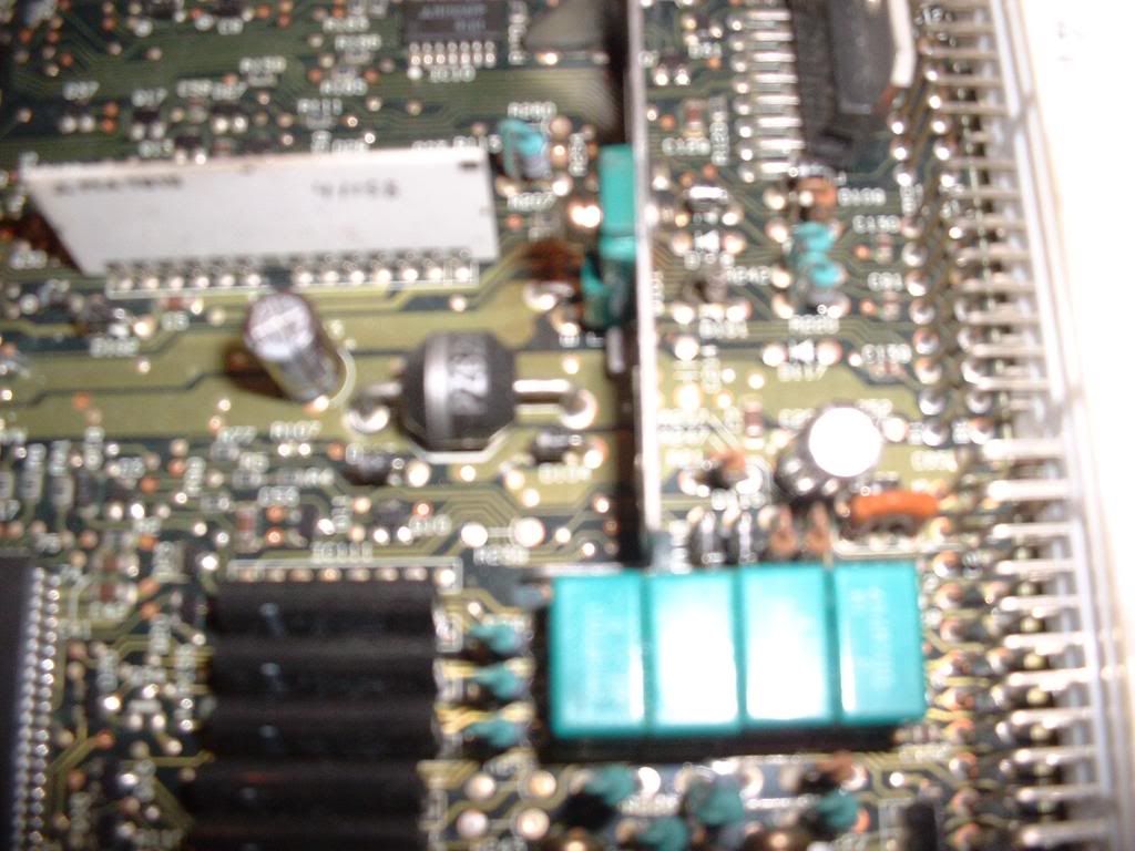

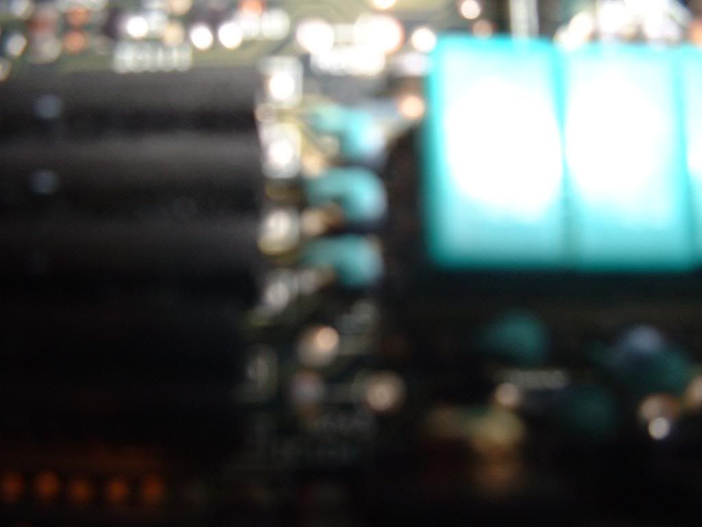

Yeah, I'll take a look if you get them posted, I used to do this kinda work in the military, so if it's a visual thing I may be able to spot it. But gripes and problems like this may no always be visual. And perhaps it may be a matter of one of the components in the ECU being fried.
If I can't see the damage it sounds like you got the shit end of the stick if you ask me. Where did you buy this from?

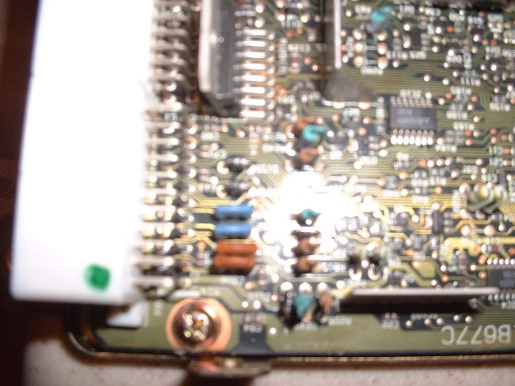

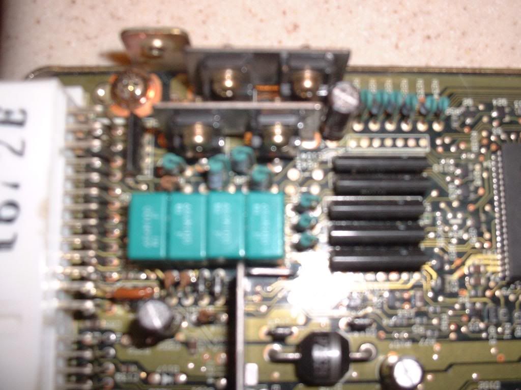

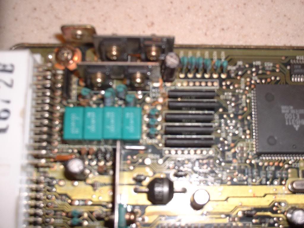

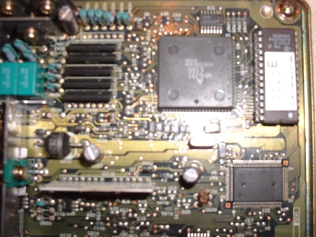

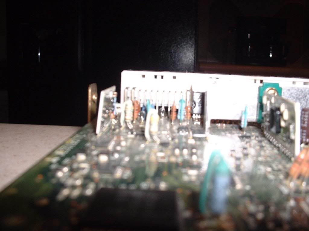

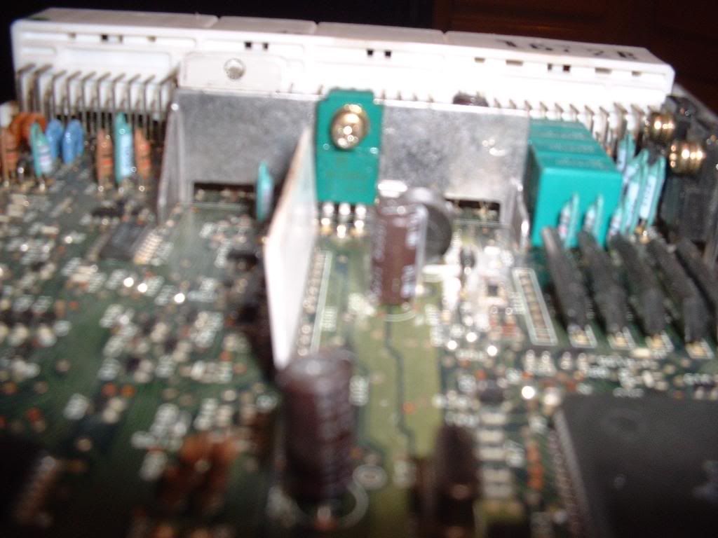

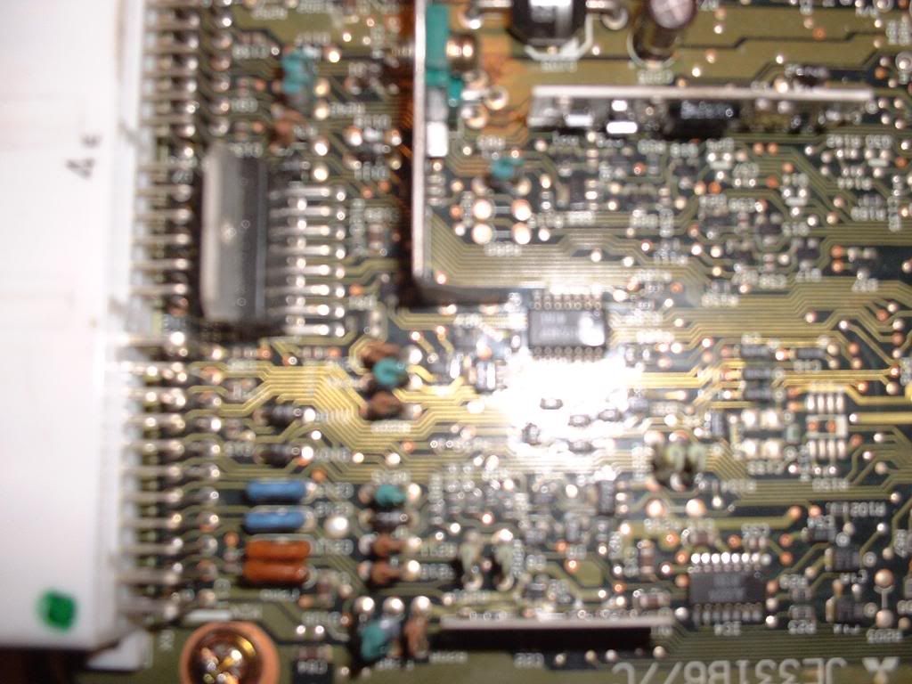

Black99GST
10-01-2007, 11:56 AM

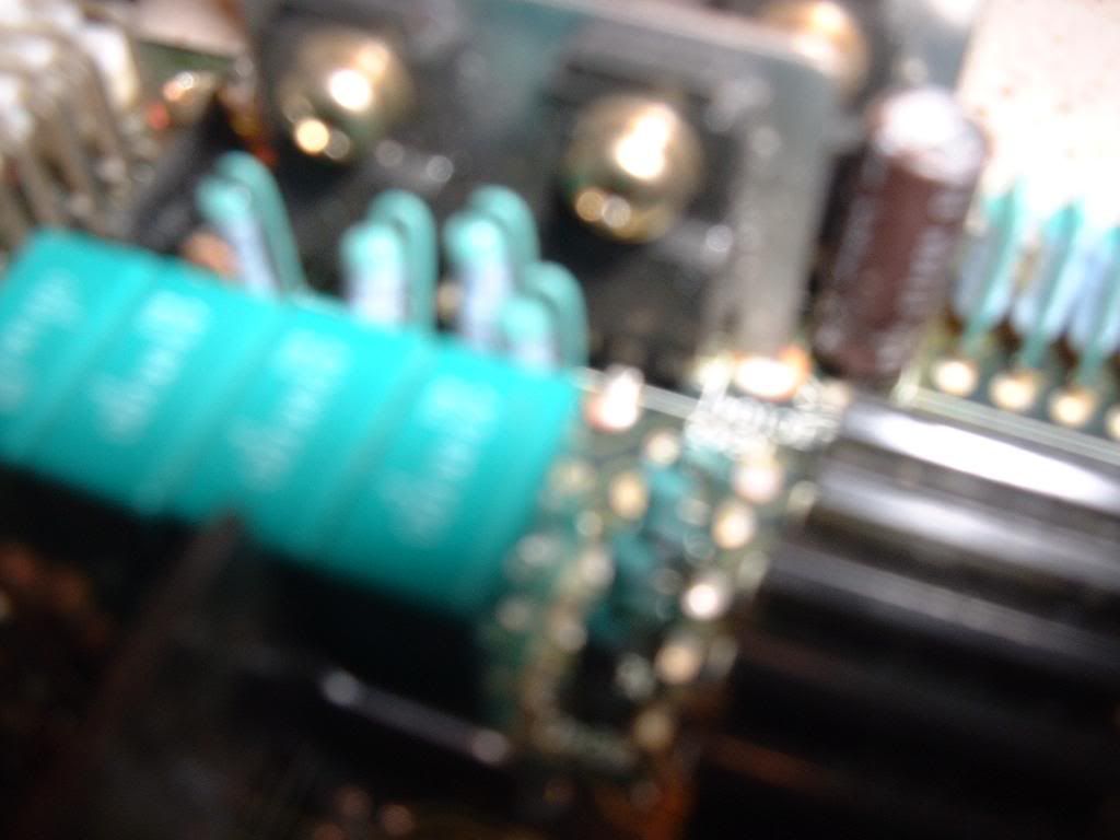

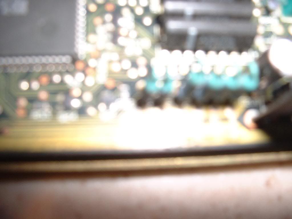

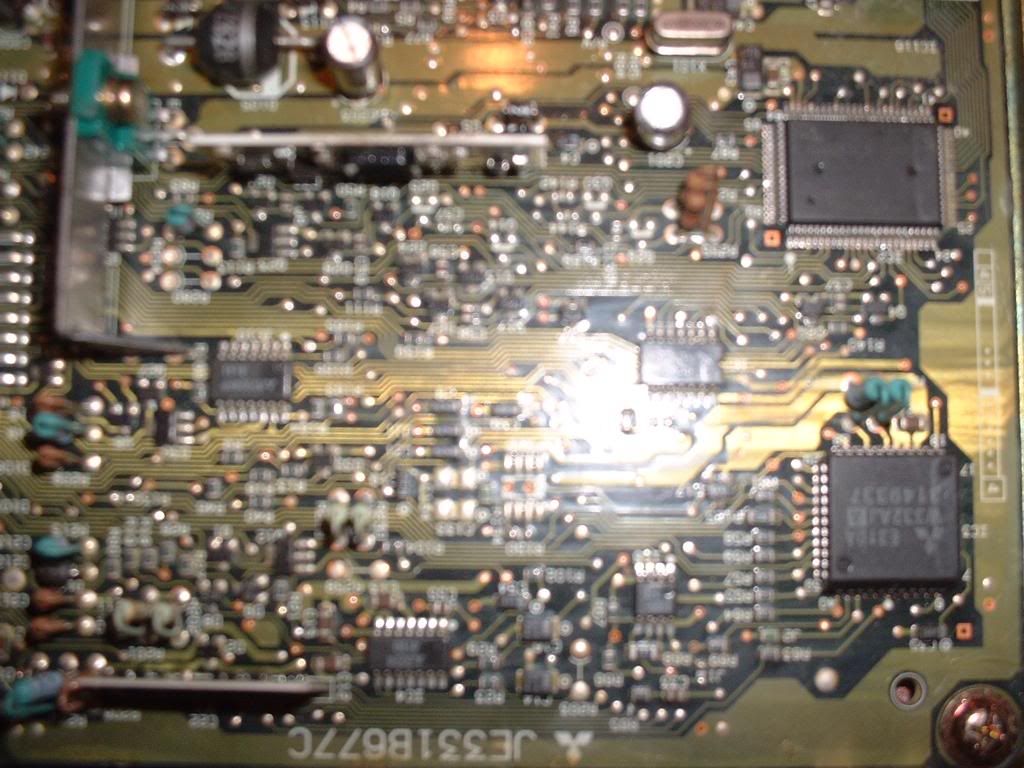

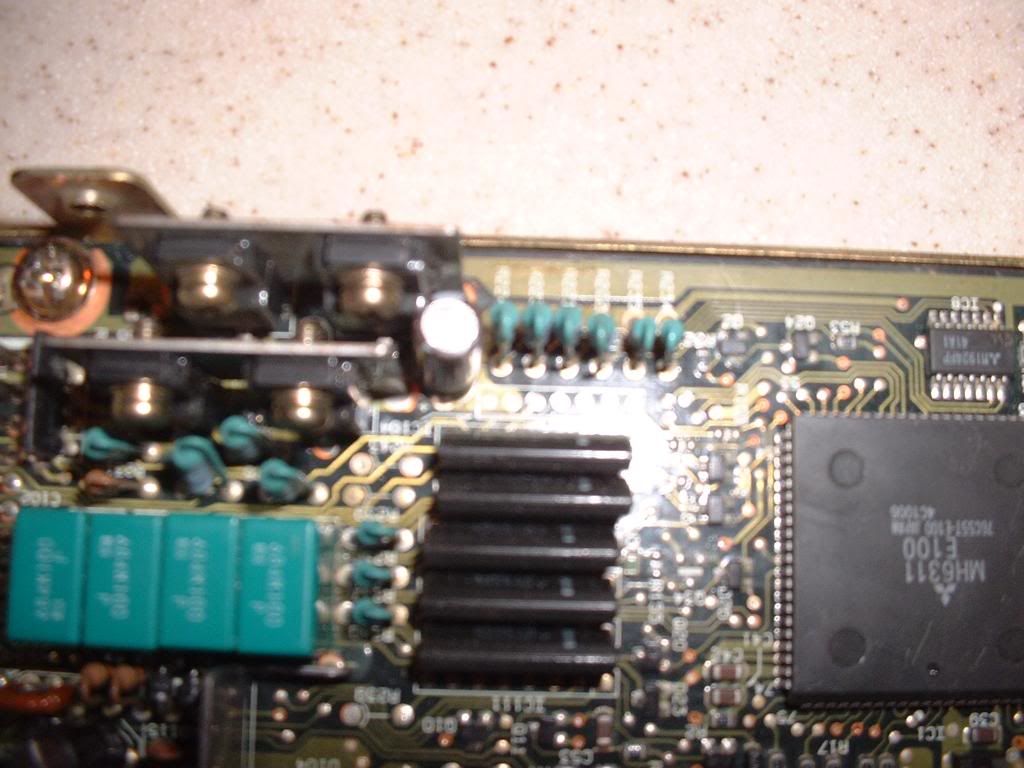

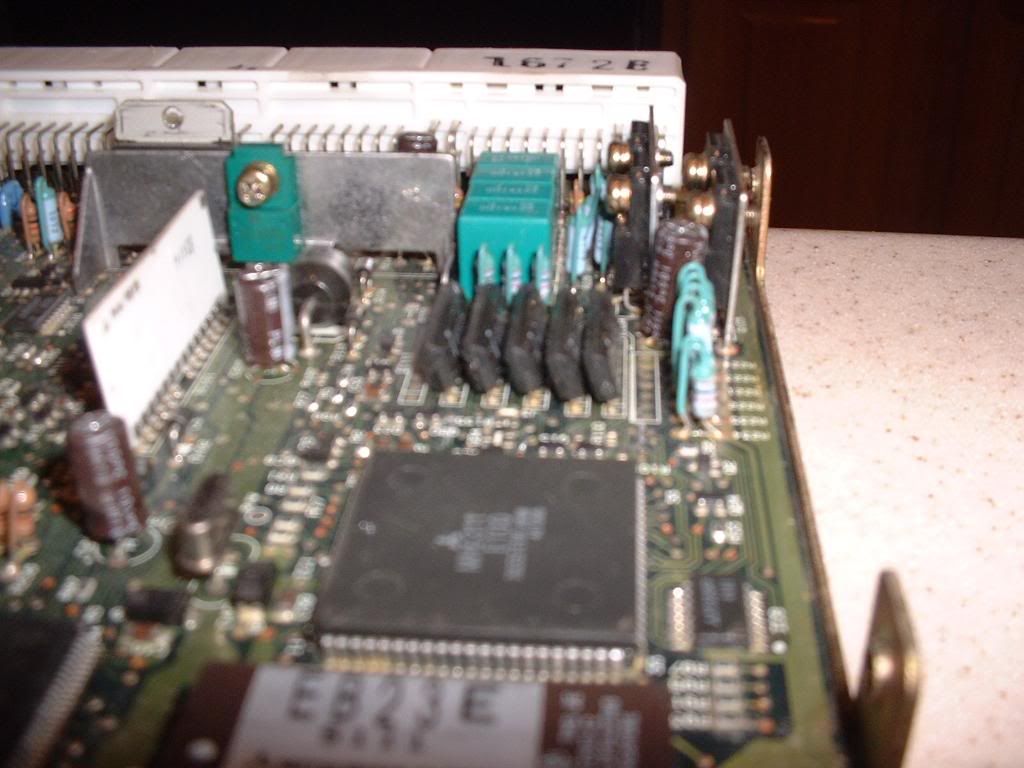

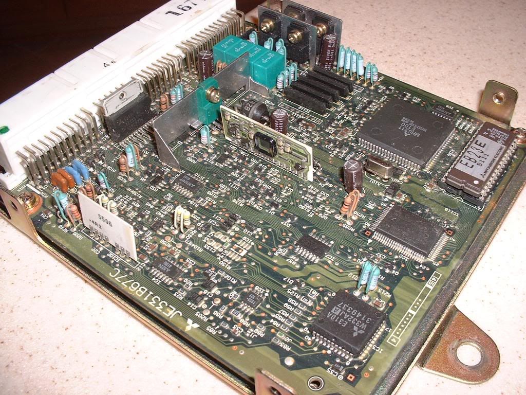

update time! ok so i sent the computer to a friend of mine who owns uprev engine management solutions here in Austin, Tx... and he found a few problems with the ECU and fixed them, well, i brought it home, and no luck again, it sounds like the relays are clicking on and off like MAD (tons and TONS of clicking... almost buzzing) then when i try to start , it just cranks and cranks... so... i'm looking for another eprom ecu... i'll get pics up though... maybe it'll be worth it... how do i post up HUGE pics?
Black99GST
10-01-2007, 12:25 PM
they came out REALLY SHITY! But...
