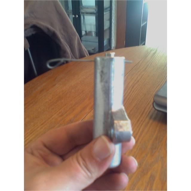

ok so i tried pressing down by hand on a bench and that was a no go...i dont have any clamps large enough to try it so ill go and pick one up today...should i just bite the bullet and just replace it and not even hassle with the old one? also i noticed a lot of spin in my old pulleys and almost no spin in the new ones...good? yes yes?
billindelicato
10-16-2007, 10:04 AM
ok being short on cash i went with a hunch...i went and got a 5" clamp and compressed the piston down...i then released it and sure enough it came right back up with no hesitation...after several tests i can deem this part as good?

FL 3.2L
10-16-2007, 02:58 PM
It's good now, but you see how much work it is to get in there. Might save you a headache and more money down the road to do it now.
As far as the pulleys go, I changed mine out for the same reason. Others say they'd only replace the pulleys if they didn't look good at the time of the swap.
