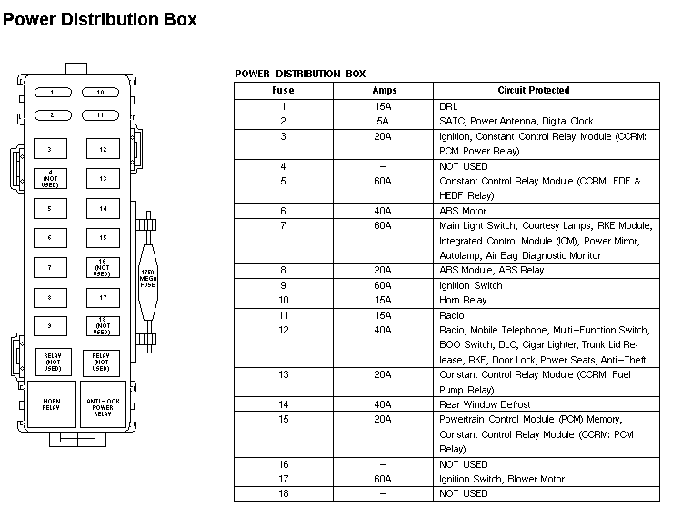

Yep, it certainly would stay at a constant temperature if the fan would switch on - there's a whole circuit whose function is to do exactly that. It obviously isn't working right now though eh. Running the fan off a separate switch is easy enough but the cooling fan circuit is pretty easy to work on so you should be able to find the fault without too much difficulty.
You'd need either a 12V test lamp or a basic multimeter. If you want to give that a try, let me know; I have the cooling fan wiring diagram here and I can suggest some tests. You'll have to do something though, because a whole lot of damage (expensive damage) can result if the engine overheats.
Edit: Actually, you don't need any test gear for the first check - take a look at fuse #5 (60amps) in the Power Distribution Box, located in the engine bay. That feeds the lo-speed and hi-speed cooling fan relays, so if it's blown then the fans won't operate.

ok ill be sure to test that.
The fan comes on when its warm out side, and it keeps the temp guage at a constant temprature; however not when its cold out side, the temprature guage tends to get higher than normal(for instance the temp guage tends to stay at about 1/2 of the range it's on, When its cold it will get up to around 3/4 of the range).
