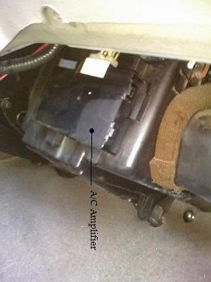

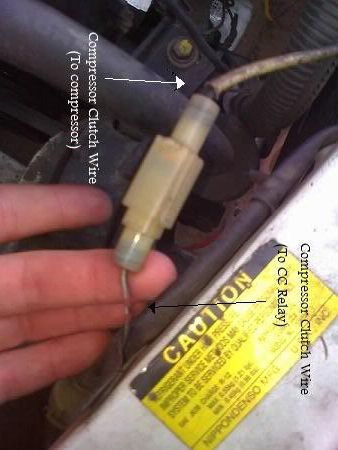

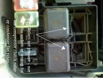

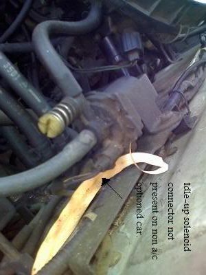

So, I did some homework.
First to begin, to address the pre-wired issue. I've taken pictures from two identical 1994 Geo Metro 3cyl 5-spds. One factory optioned with A/C and one factory optioned without A/C. While your '95 system will be different, the comparison is relevant.
http://i77.photobucket.com/albums/j64/isc20/asdf.jpg
http://i77.photobucket.com/albums/j64/isc20/rewq.jpg
The wire pictured above does not exist on the non-A/C optioned car.
http://i77.photobucket.com/albums/j64/isc20/rtyu.jpg
http://i77.photobucket.com/albums/j64/isc20/fda.jpg

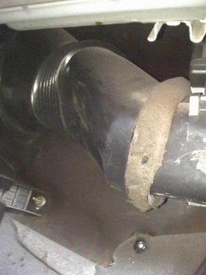

This picture and the one below show the presence and absense of the Evaporator enclosure. Notice the A/C Amplifier and wiring, which are not present on the car below that control A/C operation via the idle-up solenoid, a/c on-off switch, dual pressure switch etc..etc.. The good news is that it looks like installing the evaporator will not be as big an issue as I originally thought. You just remove the large plastic tube between the fan and heater core box shown below with the evaporator enclosure as shown above.
http://i77.photobucket.com/albums/j64/isc20/fdas.jpg
So things you need to pull from a donor car:
a) Compressor, bracket and lines
b) Condenser and fan
c) Evaporator enclosure
The wiring as I said before will be much more simple if you install a switch for the clutch and a switch for the fan.
But better yet would be a switch that controls a relay that has one control circuit and can power two slave circuits. Enabling you to turn both the condenser fan and compressor clutch on with the simple flipping of a switch. With proper circuit protection that would be an easy and clean way to by-pass the crazy factory wiring.
