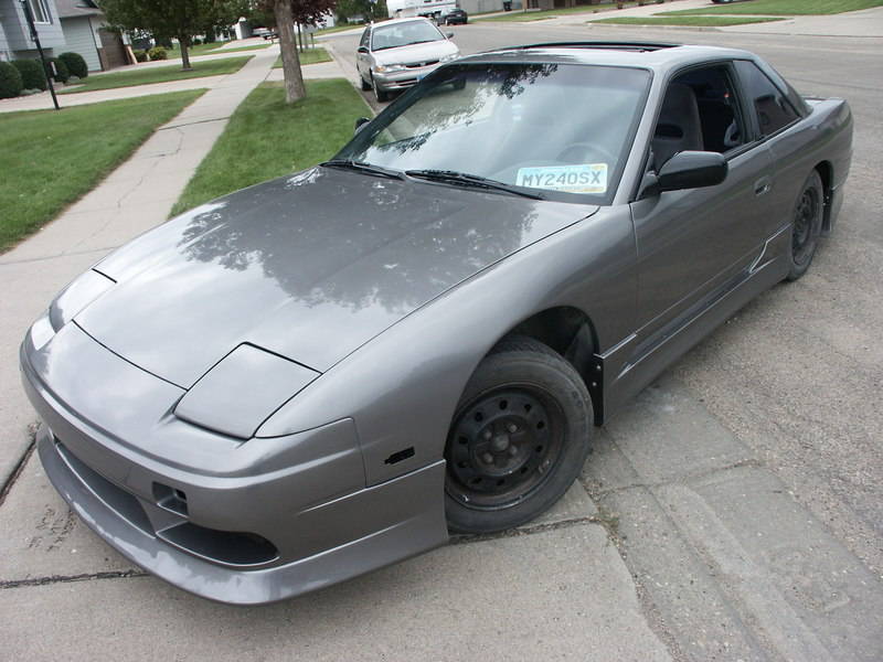

here is what mine looks like. but i paid around 850 for my kit and had to do minor sanding and cutting.. everything else
worked great. I have the origin stylish kit.
