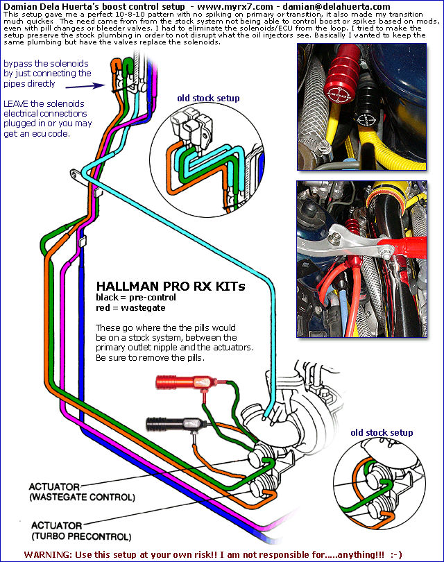

09-27-2007, 12:46 AM
Type: FD3S ALL Series
Boost control setup - Perfect 10-8-10 pattern
Ok, as many of you already know I have tried many boost control setups with no success in eliminating spikes or keeping boost at stock levels. Finaly I did a setup that gave me NO spike on primary or transition and held boost wherever I wanted. I am sure some one has already done this setup but many have asked me for detaisl so here we go.....
First, some background and theory based on what I learned from the gurus. I tried changing pills (like 40 combinations), no sucesss....I tried bleeder valves where the pills were, no success...I tried bleeder valves without the ecu, even a 3/8 valve could not bleed enough, no success.
The reason many of these setups fail to control spike (and/or maintain boost level control) is because most of these setups restrict what the actual controler (solenoids in the stock system) sees for pressure.....this restriction REDUCES the controlers reaction time, thus creating spikes. What you want is the controller to see all the pressure (ie no pill or restrictor bleeder valve) so that it can have the fastest reaction ability. However, the stock solenoids/ecu is pre-mapped, so you can never give it the full pressure signal to maintain stock boost. Really what you want is a controller (or solenoid) that can handle the full pressure signal and be adjustable in order to tweak boost settings. Also, you want to minimize the amount of hose in the loop between the pressure source, controler, and actuator... this can also help response time (spiking).
With that said, I decided to use ball/spring valves for both my wastegate and pre-control valves because they can take the full pressure signal and you can adjust the 'breaking point' of the valve.
Here is an image of my setup with comments below:
http://www.myrx7.com/images/damian_setup.gif
Some notes:
I know you can get homedepot style ball/spring controllers for cheap, but I wanted these controllers for the professional look and design...so keep the 'why did you buy those ...blah blah.' comments to yourself.
If you decide to get these controllers BE SURE to get the RX (http://www.rx7club.com/showthread.php?t=178136#) version with the lighter spring. Even at a very low setting I am at 10 lbs, with the harder spring I don't know if you can get it at 10 with its lowest setting.
If you set it up like I did then you want to start both controllers totally 'open', meaning the ball/spring combo in the valve are just barely held together. I got the valves to this point by opening them until I could hear the ball/spring 'jiggle' when I shooke it, then closed the valve a bit, then shook it, then closed a bit, then shook it, just a bit by bit until I no longer herd the 'jiggle ' of the ball/spring. This allows the actuator to see a lot of pressure and will keep boost low to start. I did this for both the wg and pre-control.
The interesting thing was that on my first runs I was already close to a perfect pattern, I was gettin a 9-7-8 with ZERO spiking on primary or transition. I set the wastegate first so that post transition boost went up to 9ish, then adjusted the pre-control to get my primary to 10ish, then the wastegate again to get post transition boost to 10ish. I have a really nice 10-8-10 with no spikes, and its really more like 10-9-10 becasue the transition has become very quick.
Keep in mind I need to keep 10lbs boost level because I still have a stock ecu, but the following flow mods: intake (http://www.rx7club.com/showthread.php?t=178136#), downpipe, and catback. So as you can see with 3 flow mods the stock system (with pills or valves or whatever) could not manage the spikes/boost../..but this style of setup can handle it just very well and I have plenty of adjustment room when I get an intercooler and PFC in, then it will be easy to adjust it to 12-10-12 pattern.
Also, you can use bleeder valves where I use ball/spring, but you may not get the same boost responce and be sure they can flow enough or you will not be able to keep your boost down!!
This is where I got valves
http://www.boostcontroller.com (http://www.boostcontroller.com/)
