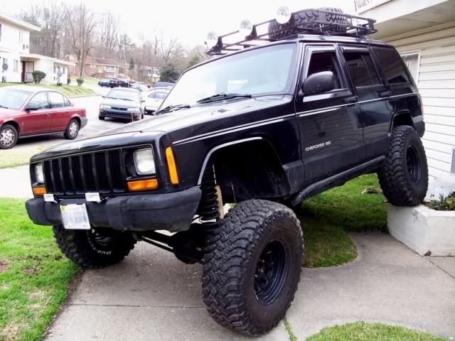

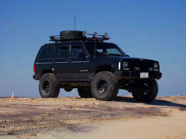

I'm at 4.5" Rusty's with 33"x12.50" BFG MT KM's: Trimmed of course...
http://i88.photobucket.com/albums/k169/citizenatlarge/100_1206.jpg
http://i88.photobucket.com/albums/k169/citizenatlarge/100_11222.jpg
http://i88.photobucket.com/albums/k169/citizenatlarge/2.jpg
*why that^ pic has a white border idk... lol*
I mean c'mon, the entire subject of bumpstop-(s/ing) isn't even addressed. (at least in the snippet there^)
I don't know what kind of rubbing would occur with stock 'short arms', (I have the Clayton set up), but yeah, i rub the lugs when steering hard-over with only 4.50" backspacing.
Currently, I don't have ANY bumpstops.(BAD IDEA!) This has definitely limited what i can play in. I'll have them straightened out for Zuhwarrie next month though... (oct 19-21 form what i've heard)
