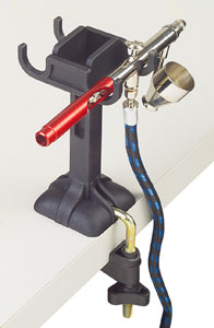

If you haven't got one already, get youself one of these airbrush holders (or similar). It certainly helps prevent paint spillage when you don't have to juggle paint jar, pipette and airbrush all at one time ;)
Plus it's a great thing to be able to just rest up your airbrush at a moment notice.

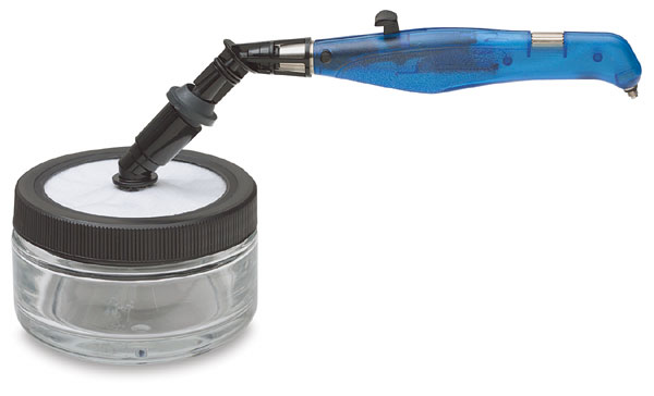

It's an Aztec airbrush cleaning station. (Cheapie airbrush sold separately.) It gives you somewhere to spray that cleaning thinner into, and the neck will mach nearly any airbrush made. I have two- one for use with acrylics and one with laquers.
My cleanup routine is as follows:
-Place thinner in color cup with eyedropper
-Partially spray out thinner, backpressure the airbrush, spray more out.
-Use a qtip soaked in the thinner in the cup to clean the cup walls. Spray out remaining thinner.
-Repeat with a bit more clean thinner if necessary.
-Turn off compressor. Remove paint cup (if removable) and store upside down
-Remove needle and wipe it down (can use thinner dampened qtip from above).
-Leave disassembled until next painting session.
Easy. It takes maybe two minutes. I really don't understand when people go on about how much hassle it is to clean an airbrush. :dunno: I use a Badger 100/150, and this method completely works for me.
The only thing I have trouble with is cleaning up after metallics. Metallic flecks are likley to show in solid colors after metallics are used, and they're nearly impossible to completely clean. Best solution is treat metallic paints as a contaminent, and get a separate airbrush- one for clears and solids, one for metallics. (I also use my metallics airbrush for spraying primer.)
