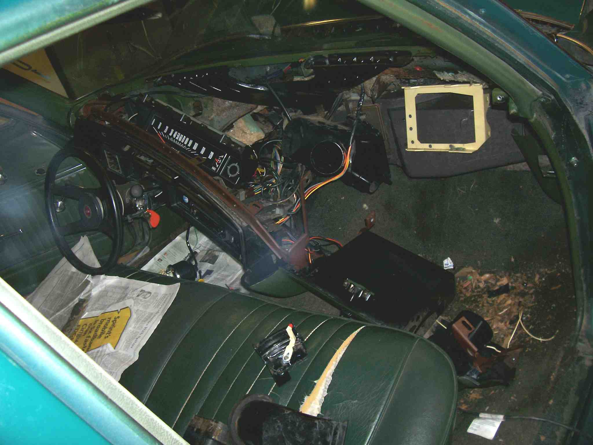

Removing the dash to rewire and to mount the ECM:
http://www.wwdsltd.com/files/DashRemoved.jpg

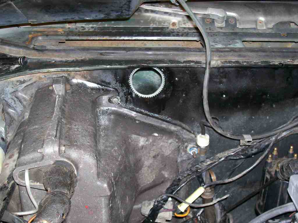

Install the wire harness bulkhead seal:
http://www.wwdsltd.com/files/WireHarnessCowlSealSm.jpg
Provide for the harness in the engine bay:
http://www.wwdsltd.com/files/WireHarnessBushingSm.jpg

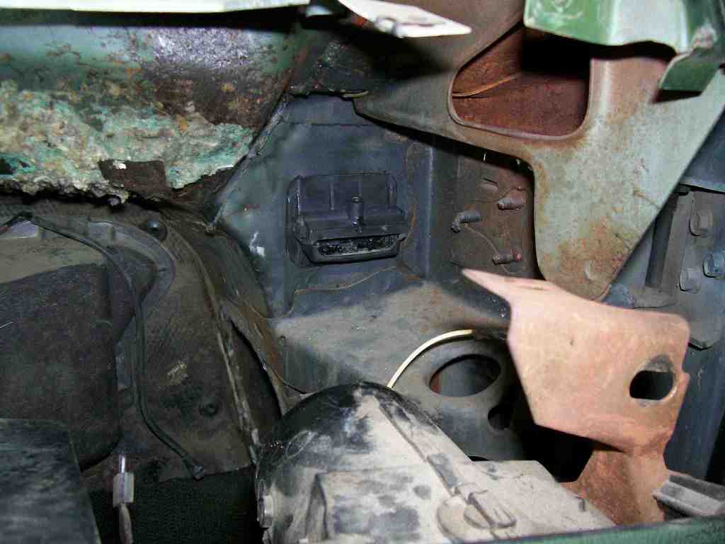

Fit up the ECM/PCM:
http://www.wwdsltd.com7/files/ECMTrialFit.jpg

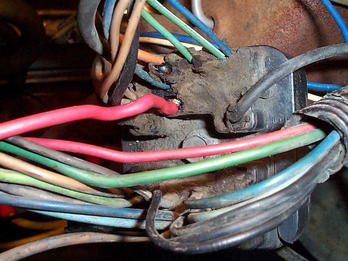

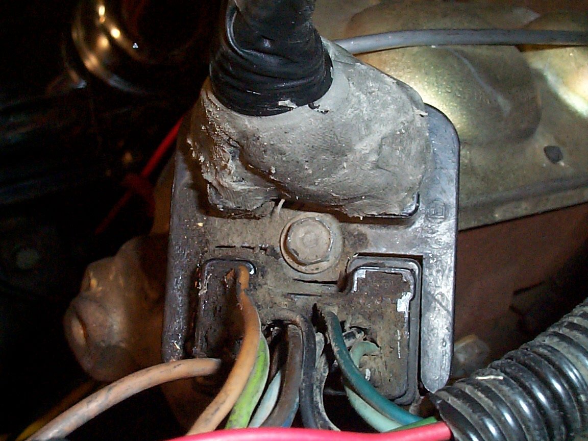

Remove the resistance wire from the original bulkhead connector and wire with AWG12:
http://www.wwdsltd.com/files/BulkheadConnIgnWireRepl.jpg
Reseal the bulkhead connector:
http://www.wwdsltd.com/files/BulkheadConnResealB.jpg

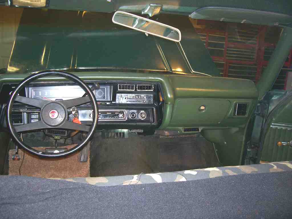

Reassemble the dash:
http://www.wwdsltd.com/files/72A-BodyDashAssembledSm.jpg

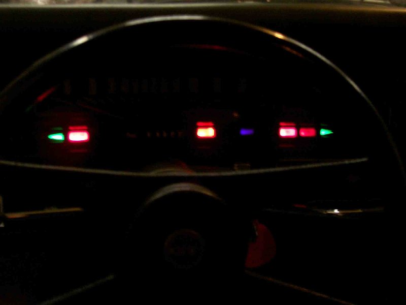

Remember to install a "Check Engine" lamp:
http://www.wwdsltd.com/files/72ChevelleDashWarnringLamps.jpg
