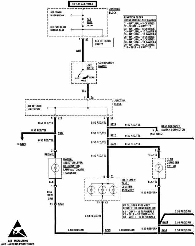

1st, Does the ashtray light and heater control lights still come on while the dash lights are out? If so, time to pull the Gauge cluster cover off, remove the screws that hold the cluster in and pull it back a little and check the electrical connections in the back for being loose or dirty.
If none of the interior lights are coming on.
Turn the headlights on, then using a 12V test light, Check for voltage at the Blue wire of the combination switch (Headlight switch)...It should have 12V.
Now test the Dimmer control switch (Illumination controller). Remove it, turn the headlights ON..... then Turn the knob all the way to the right (Clockwise). With a 12V Test light, check for voltage at the "Red with a Yellow stripe" wire 1st. Then check for voltage at the "Red with a Green stripe" wire also. You should see 12V's at both wires. If not, the dimmer switch is bad. Here's the complete interior lighting wiring diagrams.
Interior lights 1
http://i25.photobucket.com/albums/c83/MrBBody/Interiorlights1.gif

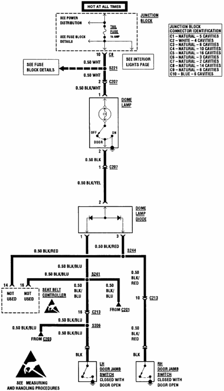

Interior Lights 2
http://i25.photobucket.com/albums/c83/MrBBody/Interiorlights2.gif

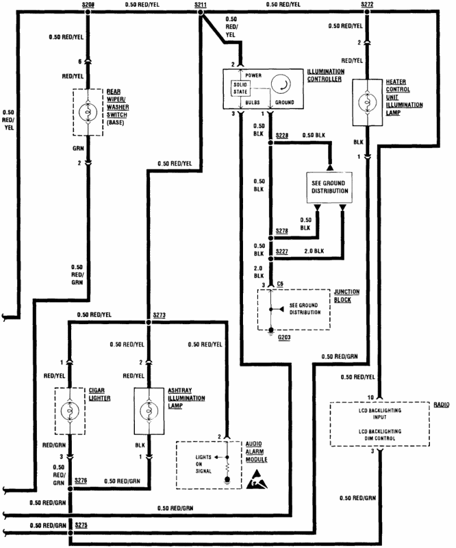

Interior Lights 3
http://i25.photobucket.com/albums/c83/MrBBody/Interiorlights3.gif
