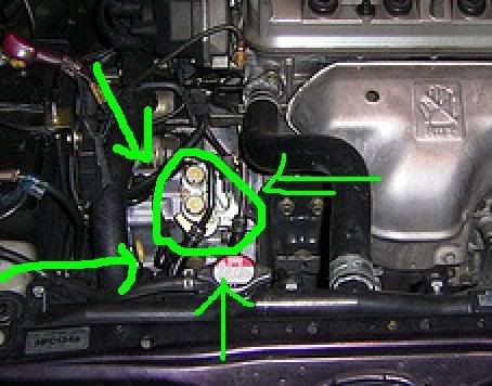

OK DO NOT TRY LUCAS TREATMENT(no offense Stealthsonic, just dont want him to make the same mistake i did), IT BOGGS YOUR ENGINE DOWN, and its really bad for your tranny, i fucked my car up that way and had to get a full tranny rebuilt on mine, Its your shift solenoids, if you get new ones and replace them now, your car will start running as smooth as ever, but if you keep delaying this problem(Experience talking) you WILL need a full rebuilt. here's some pics on where they are located.

Good luck, and do let all of us know how it turned out.
