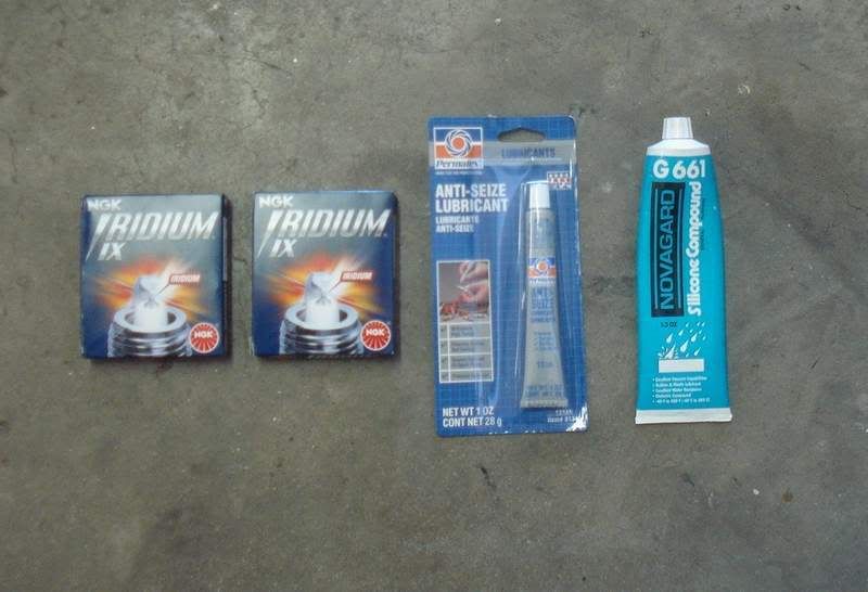

Regardless of whether you replace the ignition wires or re-use them be sure to use dielectric silicone grease on the insides of the plug boots spark plug side. Removal will be much easier next time around. Also, use anti-seize compound on the spark plug threads and do not over torque. Around 20-25 lb-ft.
http://i5.photobucket.com/albums/y186/lizzywiz/spark_01.jpg
