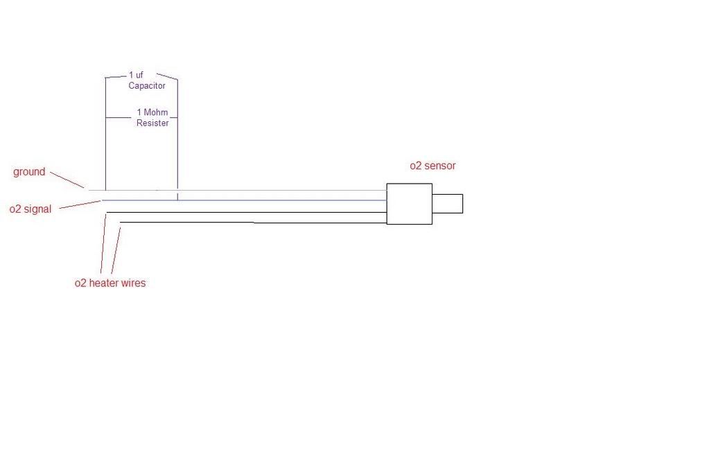

I tried to totally eliminate the o2 sensor but I still would get a cel every now and then and the 50ohm resisters got incredibly hot that it was starting to look like a fire hazard. I only used 3 but they would get to around 200F in about 15 minutes. So Heres what I did, I used a 1Mohm resister and 1uf capacitor. Hooked the o2 back up like it was stock, then spliced into the o2 signal/ground wires. And soldered the resistors in between the wires. I used to get a cel every few weeks or so but it has been about 4-5 months since I have seen one for that.
Let me draw a pic so it will be more clear.
http://i189.photobucket.com/albums/z173/SilvrEclipse/Untitled.jpg?t=1189183087

SilvrEclipse
09-09-2007, 10:11 AM
Are you trying to get rid of the second o2 altogether? As far as I know you cant eliminate the sensor completely.
I dont think it matters which way the resister and capacitor are.

SilvrEclipse
09-09-2007, 03:02 PM
And that doesn't work? I would watch those resisters to make sure they aren't getting to hot. The problem I see is that that type of setup only gives the ecu a constant reading so the computer picks that up as an error bc the signal isin't changing. With the sensor connected the signal varies but the resister and capacitor slow the reading down so that the cel isin't triggered for no cat.
