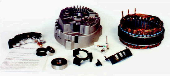

Typically, a problem like yours is caused by a bad diode leaking voltage to ground. The diode pack is located inside the alternator.
Voltage regulator is also mounted internally. Most folks will just get another alternator rather than trying to rebuild their own.
http://i4.photobucket.com/albums/y140/Docsmagic/AltKit.jpg
Breaking open an alternator:
http://www.alternatorparts.com/7140KIT2.JPG
http://www.electromaax.ca/images/kitLrg.gif
