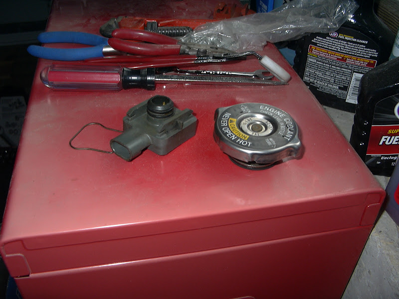

Possibility you may still have air in the system or maybe the sensor is just acting up. Try bleeding again or you can remove the sensor and clean it out as a first step. Located on the right hand side of the radiator about 3 inches below the filler neck.

Ok, this morning i got out to my car and started it. "Low Coolant" was lit. Pulled it up to the garage and removed the sensor. It was full of some brown gunk. So i just cleaned it up and put it back in. When i refilled the radiator and started the car, the light wasnt on. Nor did it come on when i left for work tonight. It looks like problem solved. Thanks so much or the help bnaylor

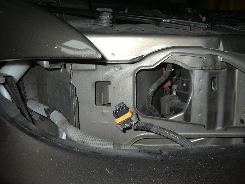

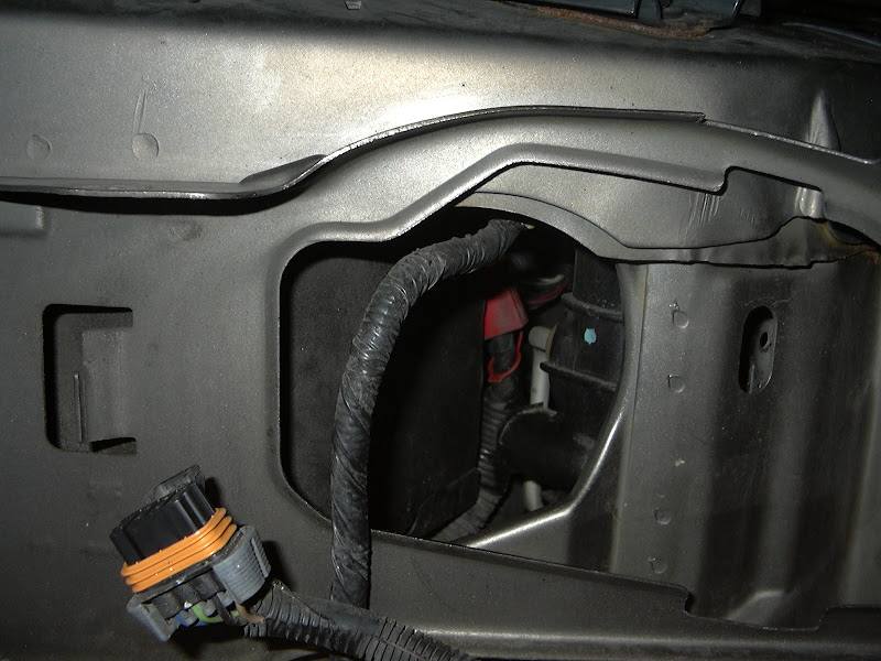

FYI, I am not sure how much a difference between my 2001 GT vs the GTP or any other model year. I removed and cleaned my coolant level sensor by pulling the headlamp only. Pretty easy and only tool I used is a narrow screwdriver to pop the metal wire-retainer... I also replaced my lower coolant hose which turned out a lot more difficult as I was unable to remove "GM hose clamp".
http://lh6.google.com/Langning.Chen/Run75HHcNZI/AAAAAAAAAl0/RPvsOpUFqz0/s800/P1020176.JPG
http://lh3.google.com/Langning.Chen/Run75XHcNaI/AAAAAAAAAl8/IeQBqvhV9TI/s800/P1020177.JPG
http://lh4.google.com/Langning.Chen/Run9AnHcNfI/AAAAAAAAAmo/UUrJK5Qdyu0/s800/P1020182.JPG
http://lh3.google.com/Langning.Chen/Run9AXHcNeI/AAAAAAAAAmg/0q8BivziTdA/s800/P1020181.JPG
