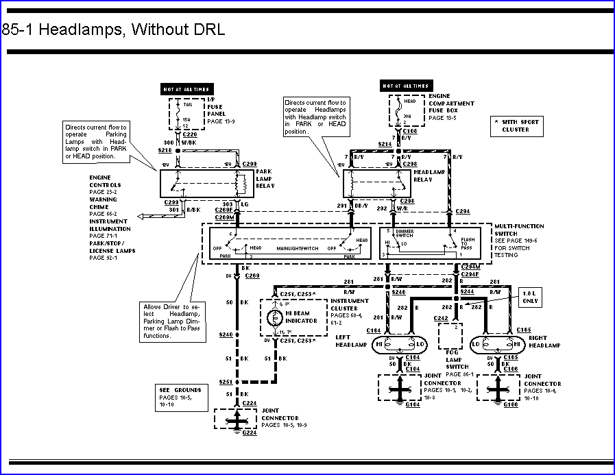

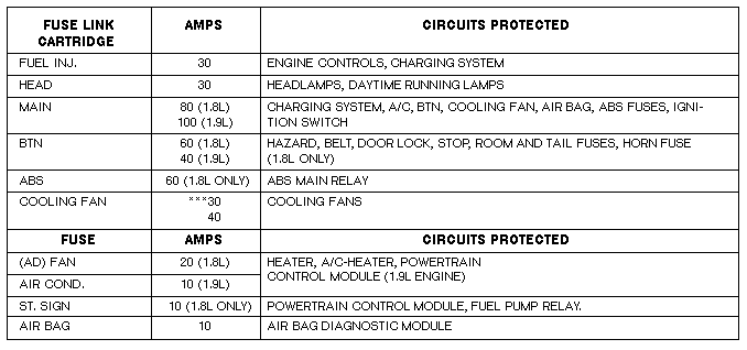

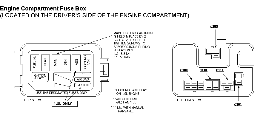

Hi dizzydog, and welcome to the forum. Here are some diagrams. The first is the wiring diagram - my Ford service manual has a single wiring diagram to cover all the '95 models.
The fuse should be the 'Head' fuse, rated at 30A and located in the engine bay fusebox. The headlamp relay should be located inside the vehicle, near to the interior fuse panel. Let me know if you need any help with the electrical fault-finding.
Wiring diagram (http://i180.photobucket.com/albums/x64/Selectron/Escort/95-escort-all-headlamps-wiring.png)
Fuse designations (http://i180.photobucket.com/albums/x64/Selectron/Escort/95-escort-fuses-01.png)
Fusebox layout (http://i180.photobucket.com/albums/x64/Selectron/Escort/95-escort-fuses-02.png)
