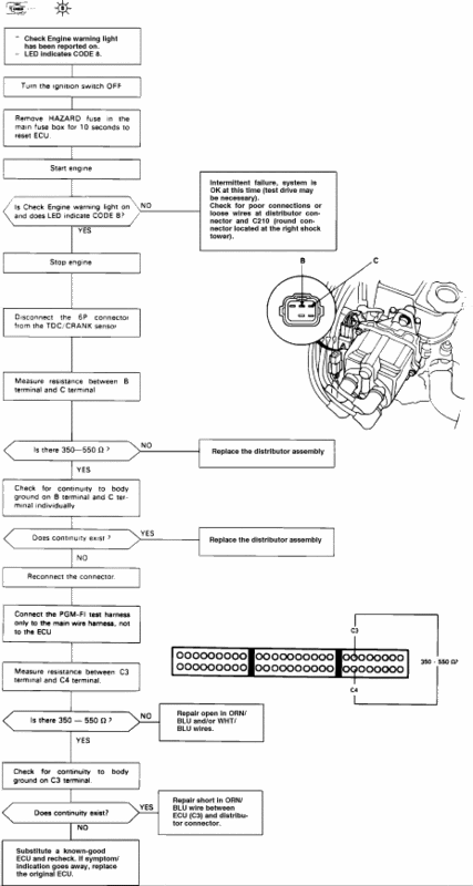

Lift up the carpet under the passenger side footwell and count the blinks if there are any, my bet is there are 8.

FrodoGT
09-04-2007, 03:52 PM
top dead center sensor.
A 7 isnt too unlikely either. and thats the tps

thanx again..but u are talkin to a honda newbie....what is top dead center sensor?
Hybrid1990crx
09-04-2007, 07:02 PM
i think he means the crank sensor. ive never heard of a tdc sensor.

Hybrid1990crx
09-06-2007, 05:50 PM
http://i128.photobucket.com/albums/p182/generictricycles2/tdc.gif
Thats straight from Alldata.
If you can't read it i'll try to resize it. Its the same thing.
