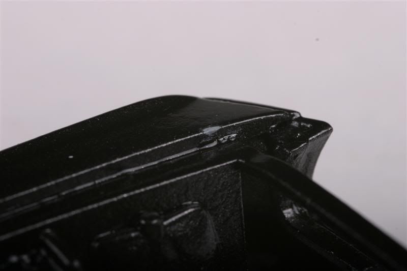

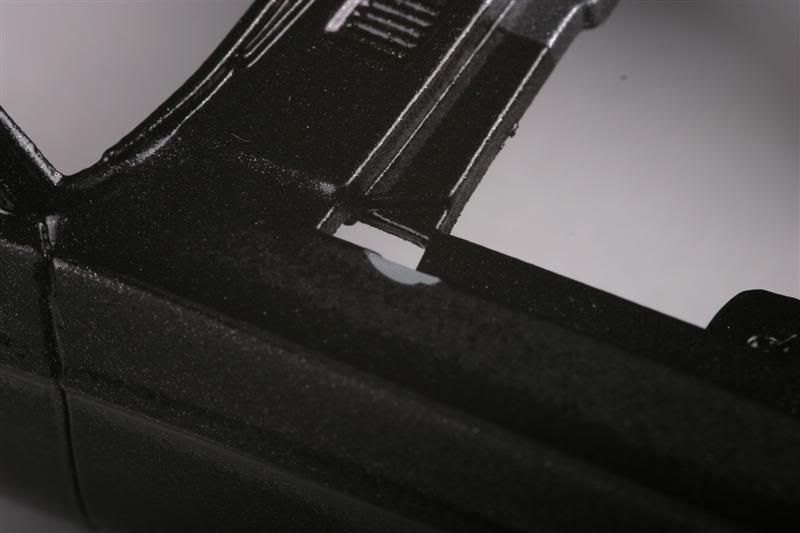

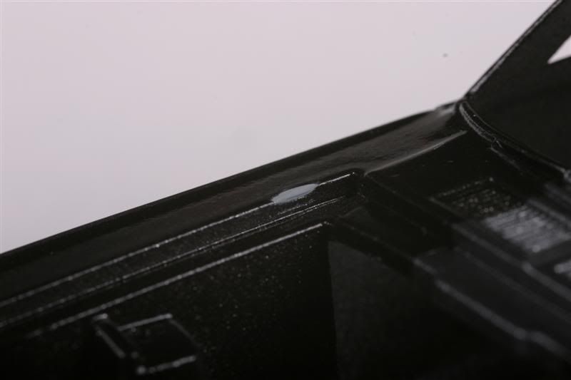

Hello all,
I had this body drying with the hood in place for about a week. When I removed the hood, two pieces chipped off. I also noticed that the tape for the stripe pulled up some paint as well. The coats of clear have already been applied.
My question is: what can be done to repair this? Do I have to strip it? Can the paint be filled? There is definitely some depth to the paint/clear. The body turned out pretty good, so it's only natural this would happen. I could really use some expert help! :frown: :frown: :frown:
http://i203.photobucket.com/albums/aa73/wallacesells/IMG_3124Medium.jpg
http://i203.photobucket.com/albums/aa73/wallacesells/IMG_3125Medium.jpg
http://i203.photobucket.com/albums/aa73/wallacesells/IMG_3126Medium.jpg
http://i203.photobucket.com/albums/aa73/wallacesells/IMG_3127Medium.jpg

Automotive paint across the board. Duplicolor's generic primer, followed by duplicolor silver. Stripe was masked off (after it dried for a few days), then metallic black (also duplicolor) was shot over it. Dried a few days and several coats of T125 duplicolor clear. Chip goes down to the primer.
This was painted during high humidity weather. I'm guessing this affected the adhesion of the paint? I also wetsanded the primer with 2000 grit (which I do with ALL my bodies). Maybe this had a part in the problems?
Unfortunately, the knicks are showing whether the hood is open or closed and I don't make dioramas (and can't stand errors like this). I'm guessing stripping is the easiest? I'd like to try and fix it first. If I goof, I can always strip. If it works, I've learned a new skill.

It is possible to repair chips like this, particullarly if you're using laquers and an airbrush. It does take effort and patience. I'm assuming you mean spray cans, and if so this will make repairs a good bit more challenging.
The steps are pretty straightforward:
-Sand the chipped areas with fine sandpaper, say maybe 1500 automotive finishing paper. The idea isn't necessarily to make the chiped edges disapear, just to take the 'step' down a bit.
-Then apply primer to the chipped areas. Prime, sand, inspect, and repeat until the chip edges are gone and you have an even surface to apply the paint to.
-Apply paint to the newly primed area until opaque, then lightly mist the general area for blending.
-Clearcoat as normal.
I've certainly done this before, and done properly there is no trace whatsoever of a repair job (but it does take some practice to pull it off!). This does mean you are applying primer, paint, and clearcoat over clearcoated paint. There's no guarantee the repair won't be visible, but I've had good experinces with it.
The reason the airbrush is useful is that you can work a quarter square inch area and leave the surounding areas alone, and you can control the volume of paint and primer you're applying. That's a pretty good trick with a spraycan. You could possibly make a masking shield by cutting a small hole in an index card and spraying through it- but I can easily imagine running out of hands doing this. The primer and paint need to be applied in very small, light, patient applications. And definately don't try to do it all in one afternoon.
If the cans you're using are enamel, all bets may be off. Enamels behave differently than do laquers, and their something I just can't advise on as I don't use them. :dunno:
As you mentioned above, you have nothing to loose in trying other than time, and you certainly can gain some very valualbe skill in painting (and maybe even save your paint job!). Take it slow, good luck, and tell us how it goes.
