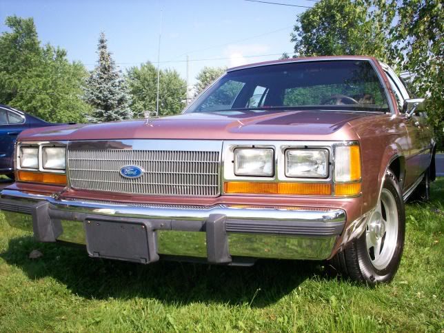

Here's the car before the new suspention, nothing special, just showing you..

By the way...your car looks fantastic.

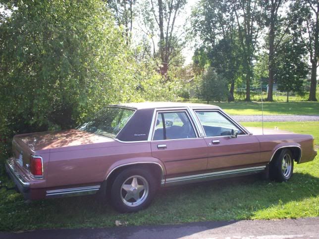

Well thank you :) Here's a couple more..
