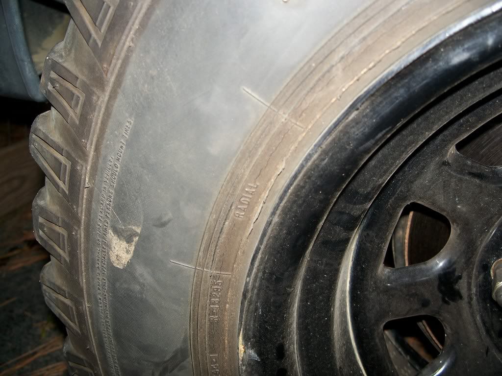

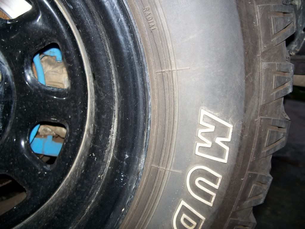

Thanks for the tip. If you can see this crack that runs around the tire about 1" away from the bead. That is what appeared on all 4 tires.

How much air are u running in those tires??
And, yes, those are typical cracks from a vehicle having sat for some time in between movement.
When the tires spin, they tend to keep themselves pretty well lubricated, when they are left to sit, they dry out much faster.
My boat tires looked like that, only slightly worse. If you bought those tires from a shop in town, I would highly suggest asking them they're opinion on what they feel with them being safe or not.
Generally, if they have mild cracks, few and far between each one, not one long continuous one going around the rim, your looking at normal drying out.
Your cracks are continuous and go all the way around the rim, from what I can tell. I'd have them checked, and keep your speed below 50mph until you're able to.
Next time you're on leave, best thing to do, is to get some half tire covers from a boat/rv store, and cover those tires up from the elements. That helps a lot.
Keep me posted. Very nice truck, and that's a beautiful section of property you have there.

There are at 35psi. I just ordered some Big horn MT tires from a local shop, they will be put on tomorrow. I asked a few local shops and they all said that they probally should be left to lower speeds and cooler temps than the 100's that it hit this week.

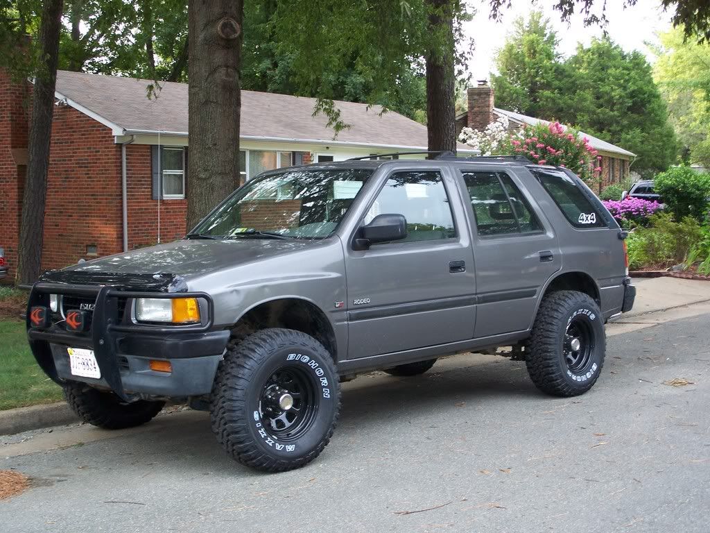

http://i233.photobucket.com/albums/ee166/offroadgearhead/100_3841.jpg
These are the Maxxis Bighorn Mud Tires. I havn't taken them in the Mud yet, but they ride alot smoother on the road than the Pro Comps, Thay also make ALOT more noise. Hopefully they will blend in with all the other random noises my truck makes.
