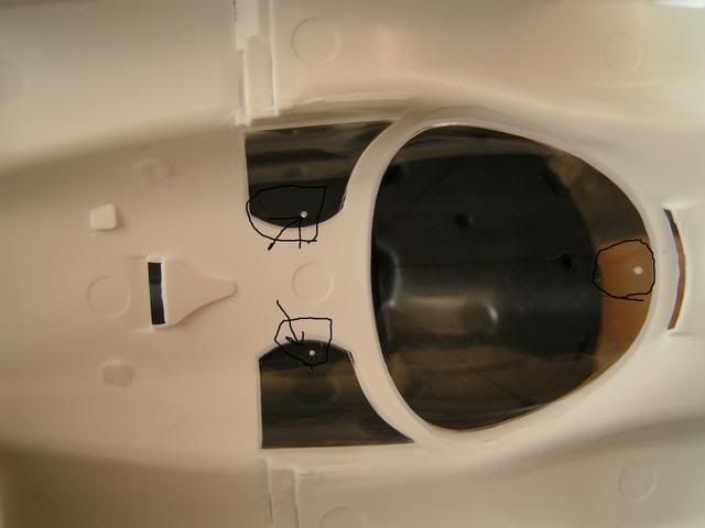

OK ... I have first Tamiya 962 kit and I am now understanding all of the limitations of the molded in glass. My main question is ... what do I do about the connection point that is on the inside of each piece of glass? If you seen this kit, you know what I mean. The little nub of spue that is on each window. How do I get THAT off without totally scratching up the entire windscreen! Help!

Pic, man, give us pics!...

Sand it away, then polish the glass just as you would polish the paint. Take care, and time, and you'll never know it was there.

Thanks. I guess I'll hit it with a very light sandpaper and then some Tamiya compound.

Yeah, sand and polish them out. I'd recommend a sequential set of sanding sticks followed by a polishing stick, then rubbing compounds. A PITA to be sure, but at least the body and clear parts should be pretty sturdy, and the points aren't in grossy obnoxious places.
