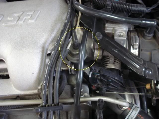

According to the OP's prior post history this '00 Grand Prix SE has a 3100 engine. See pic below for FPR circled in yellow.
http://i5.photobucket.com/albums/y186/lizzywiz/fpr_3100_02.jpg

Thanks for the pic...however, how can I check for fuel contamination and the hose that attached to the fuel pressure regulator is that the vacuum line? What the needed step or procedures to solve the problem with my car?

Pull the vacuum line and look plus smell for strong presence of gasoline. This checks for a possible ruptured diaphragm within the FPR and is an easy obvious check. If nothing visible then check fuel pressure. A flaky FPR can cause hard/difficult starting but a fuel pressure check can rule it in or out as the possible cause.
