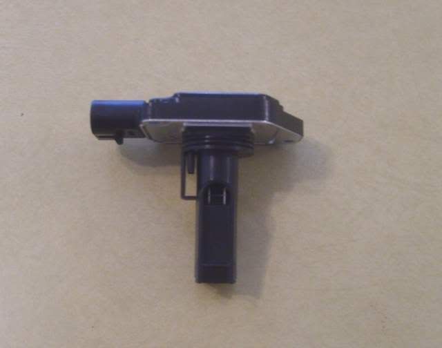

Although I haven't used it for years there is probably nothing wrong with using rubbing or isopropyl alcohol on MAF sensor wire elements and the thermistors. The advantage of the MAF spray cleaners available at any auto parts store is they allow no contact with the relevant parts of a MAF with the exception of pushing the spray button so Murphy's Law is not invoked. "What can go wrong will go wrong". Also, does not leave any residue.
This MAF sensor was replaced due to improper cleaning. Worked before removal, then set a MAF DTC after cleaning.
http://i5.photobucket.com/albums/y186/lizzywiz/maf_sensor.jpg

nupestp
08-24-2007, 02:10 PM
Referring to the picture of the MAF sensor above...when I disconnected mine, there was no "tube looking" thingamabob on the bottom of mine, just the part that I would guess is the "plate".....and which part do I spray, the wires in the middle????
dtownfb
08-24-2007, 03:06 PM
Yes and all the area around it. I used a soft clth and dabbed it dry. Also clean out the throttle body plate while you have the MAF off. Teh first time I did miine, the throttle body plate had carbon buildup. made a huge improvement with throttle response.
Hoppy2
08-24-2007, 03:08 PM
The wires are the sensors. This is what you have to clean the grime and dust off of.
