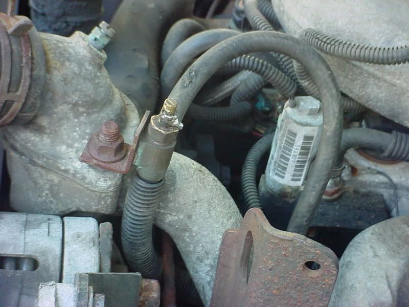

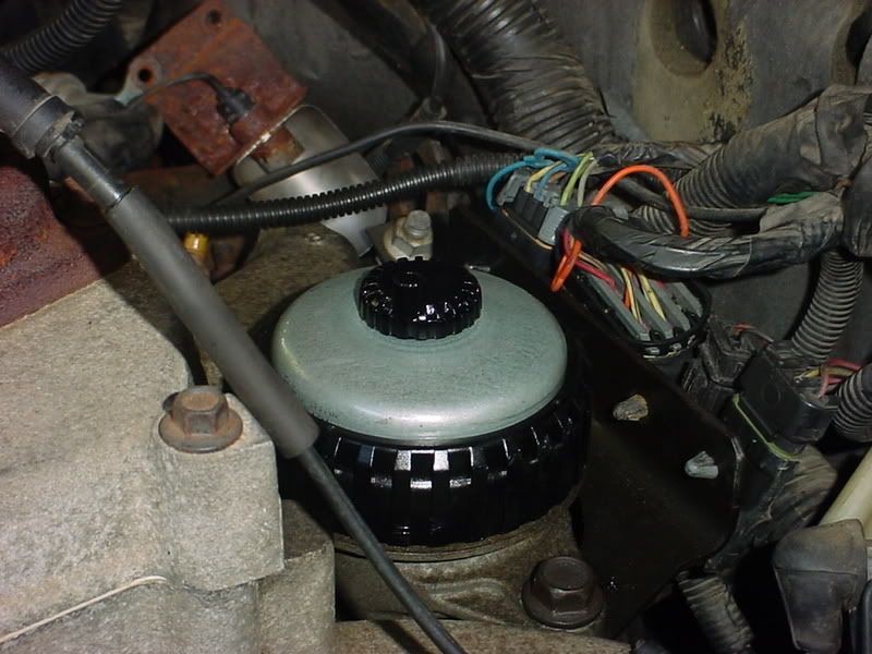

I've got a 94 1500 silverado with a 6.5 liter diesel running about 220,000 miles. After 5 mins or so of driving it will stall out. After restart it'll run for 10-15 seconds and then die. If you let it sit for 20 mins you can get another 5 mins. of driving with it. I thought it was water in my fuel so i added fuel dry, empty'd fuel out of both valves on the motor, shown below, new fuel filter, plus i let it idle for 4 hours with the fuel dry. After that it was good for a day and now its acting up again. My manual said there was a valve on the bottom of the blue filter element to drain water but when i stuck my hand underneath it was just smoot on the bottom. Any help would be awsome. thanks guys.

It sounds like fuel pressure. Check the fuel pressure to the injection pump. Should be 4# or more.
