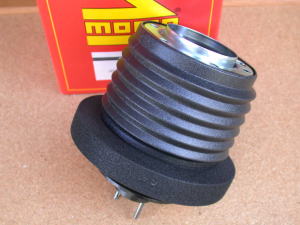

Hey I went to my Canadian Tire today and bought this wheel,
http://www.mx5parts.co.uk/product_info.php/products_id/929
Mines red and black, what hub do I need for it, they dont sell any at canadian tire, and theres no rubbing thing on the wheel, looks like this
http://www.italiazakka.co.jp/shop/goods_img/14_17_G5A003_0_01.jpeg
what do I do?? Lance, you know, should I jsut return the wheel? help!

You need Momo hub adaptor, part #2401
yhandor
08-05-2007, 12:29 PM
where can i find one

K Lance I got the hub and wheel here what do I do?

Okay its on, but i havent wired the horn. You have to get a wheel puller, Canadian Tire rents them, andyou get all the money back when you take it back. get the puller that screws into the 2 holes after you take the airbag out, I used one at first that clamps around the edges and bent the stock wheel to shit, and didnt move, with the screw one came off instantly. Then take off that plastic ring thing, its black and yellow, its for the airbag, rip it off theres a clip in the middle of it you gotta pry off thats holding it to the steering column, cut the wire that came off you air bag short so it does hang or tuck it somewhere, then what I did, put your hub on, not allthe way, enough so you can pull it off still but still steer, then attach the wheel to the hub, dont put on the column nut yet, take the car down your road, go straight, pull the wheel off, which is attached to the hub, and while the car is coasting straight, put it back on so your wheel is straight, then get back home, take the wheel off the hub, I hammered the hub on, put a board over the hub and hammered to get it on, then put your steering column nut on, and then your wheel back on and enjoy!
