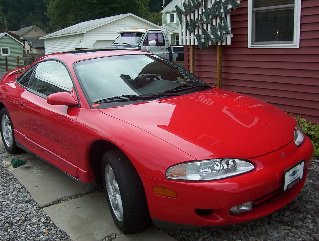

OMG ECLIPSE98GST YOU MAY KEEP YOUR LEFT FOOT BUDDY!!!!! YOU WERE ABSOLUTELY RIGHT!!!!!!!!!!!!!!! OMG all this time and it was the spark plugs........well we feel it was the wire as well cuz it had some major cracks in it and we think it was sparking outside the wire. But you guys have no idea how happy we are to have this fixed!!!!!!!!!!!!!! what a relief! :grinno:
i gots my baby back!!!!!!
http://i183.photobucket.com/albums/x314/tukester/000_0444.jpg
