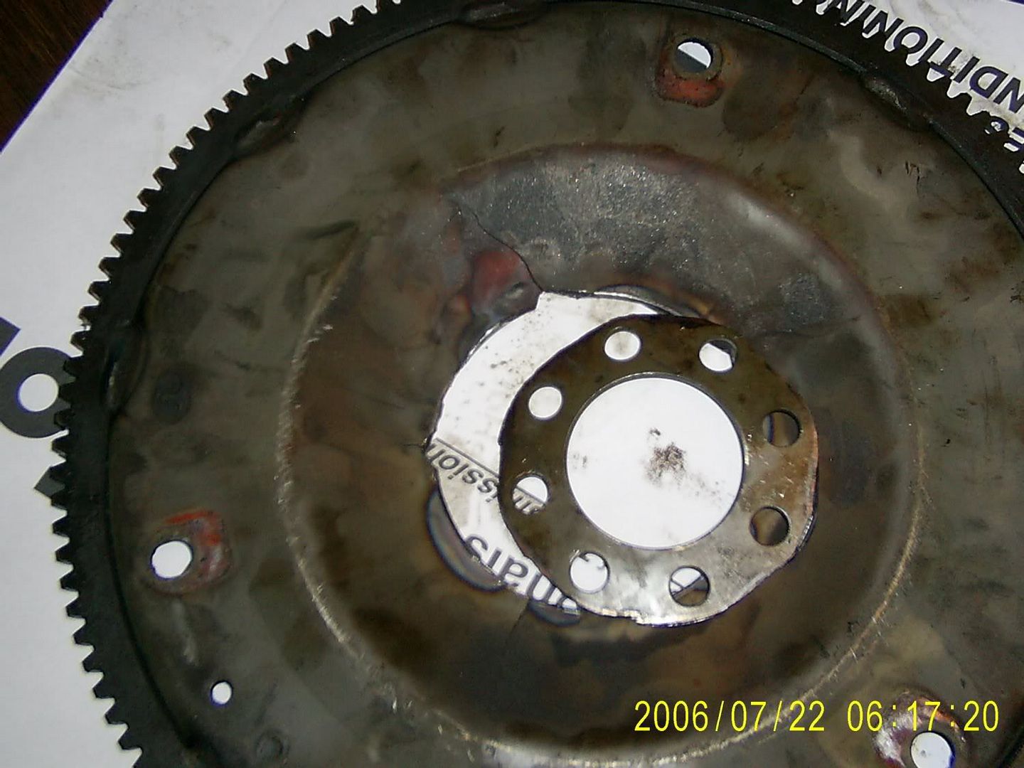

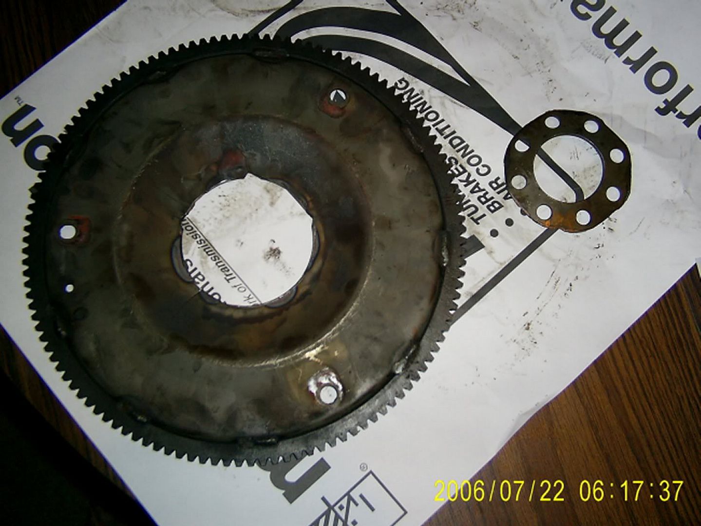

disguiz wrote:here is a link to a couple pics of my broken flywheel
http://i99.photobucket.com/albums/l282/disguiz/flywheel1.jpg (http://i99.photobucket.com/albums/l282/disguiz/flywheel1.jpg)
http://i99.photobucket.com/albums/l282/disguiz/flywheel2.jpg (http://i99.photobucket.com/albums/l282/disguiz/flywheel2.jpg)
THE MOST COMMON CAUSE OF THE FLYWHEEL BREAKING IS THE DOWEL PINS BEING LEFT OUT OF THE BACK END OF THE ENG , THEY MUST BE THERE ,JERRY
so it souinds pretty convincing to me. hold their feet to the fire !
