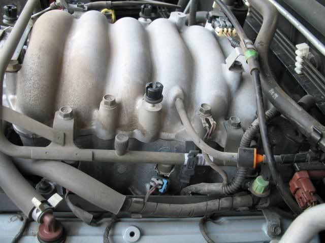

Gizmo42
07-13-2007, 12:39 AM
Its on the drivers side of the engine next to the fire wall.
Behinde the solenoid with red plug on the right side of this pic...
http://i30.photobucket.com/albums/c337/Gizmo420/Img_0501.jpg
Another veiw from the top..
http://i30.photobucket.com/albums/c337/Gizmo420/Img_0507.jpg
I've never done one but apparently the screws can be a real pain to get to.
