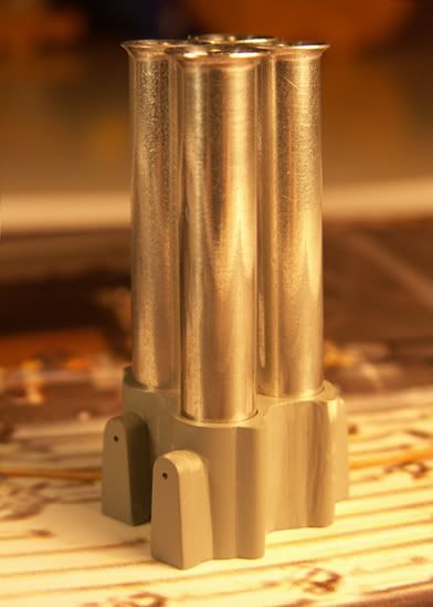

Check out Stevenski's Super 7 build (http://www.automotiveforums.com/vbulletin/showthread.php?t=680549) for an easy, great looking solution.
Happy Martian
07-08-2007, 09:24 AM
The items Stevenski used are uninsulated bootlace ferrules, and should be available from most electronics stores

Thanks for the posts.
Going to try the electrical terminals first (I even posted in the thread!!! hah!)

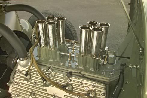

Do a search for "funnel" on this site and get some from Sakatsu.
Pah, far too easy!:grinyes:
http://i208.photobucket.com/albums/bb224/cinqster-photo/hitech_hilborn.jpg

Nice. Scratch built manifold?
cinqster
07-16-2007, 04:19 PM
Cheers. Yes, it's one half of the trick Troy Trepanier Hilborn set-up. Still unfinished - as usual!
http://i208.photobucket.com/albums/bb224/cinqster-photo/6.jpg

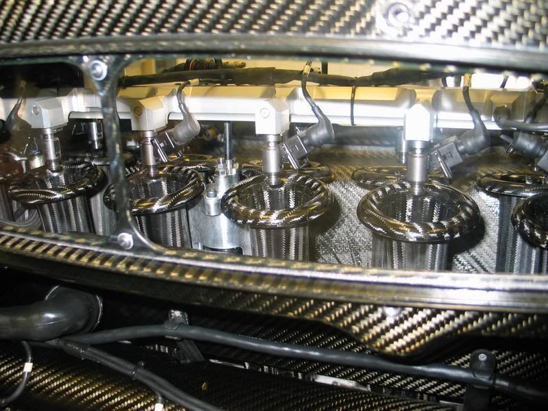

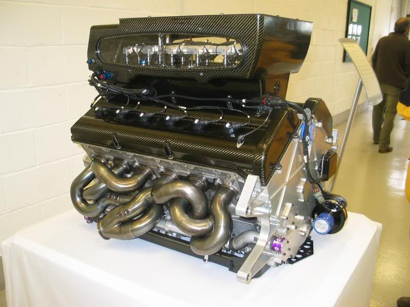

But why make do with plain metal stacks. Why not make them from carbon fibre ? :iceslolan
http://i90.photobucket.com/albums/k249/HappyMartian/Prodrive%20Open%20Day%202007/IMG_0231.jpg
These are from an Aston Martin DBR9 V12 engine, photographed at a Prodrive Open Day over the weekend.
http://i90.photobucket.com/albums/k249/HappyMartian/Prodrive%20Open%20Day%202007/IMG_0229.jpg
