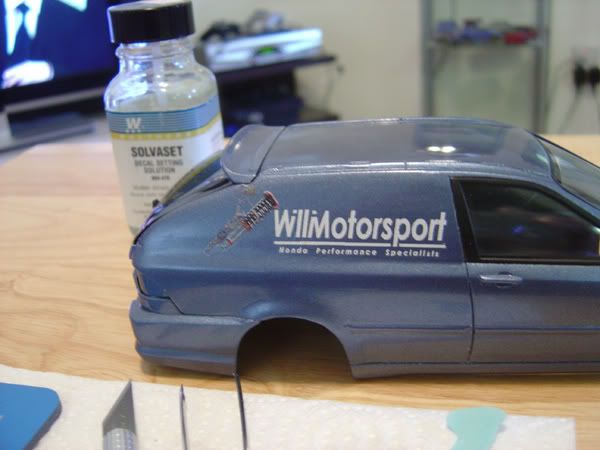

A while back, I had a friend print me out a heap of decals on his ALPS printer, but one of the limitations of his set up was that it wouldn't print white, and then also other colors on TOP of the white. Also, I wasn't terribly thrilled with his resolution. For example:

Was printed out, the girl wasn't over white nor her resolution good, so it turned out like this:
http://img.photobucket.com/albums/v417/willimo/crappygirl.jpg
So what I wonder, is this a limitation of all ALPS printers, or just his setup? Would I have to print out the white background as a separate level, and apply one decal on top of the other? And are ALPS printers capable of 300dpi+, unlike what mine came out as? Does anyone have an ALPS which they are willing to lend me? (Just thought I'd toss that last on in there! :p )

As I can see from the photo, he didn't print a white background for the girl and it ended up transparent against the blue on the surface you applied on.
Taking your design as an example, make a solid black silhuette of the girl & shock absorber on a separate layer, on the exact same position as the original design. Now set up so that only the black silhuette is visible and printable, invis/unselect anything else. Go to printing options and check and select spot color and some other option, can't remember name, that makes the printer hold onto the paper and won't eject it till you tell it to. Install a white ribbon instead of the black one and print. It'll print a white silhuette on your paper and it won't eject the paper. Now make your original design visible/printable, uncheck spot color and hold the paper from the printing options and print. The alps printer should roll back the paper and print the color design over the white silhuette without any misalignment.
