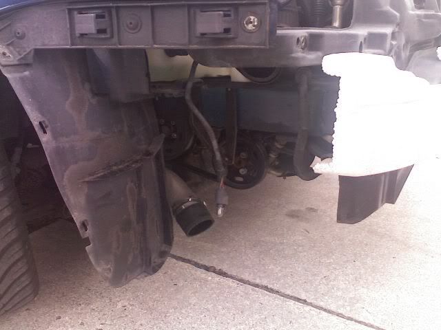

Nope! After snooping around under the car, it was night by the way and i was using my phone as a light, I found that the intercooler sensor wasnt connected. I started laughing like crazy cause in our rush on satuarday to put the car back together cause it was going to rain we forgot to connect it.
I connected it back, reset the ECU and took it for a spin. Boost shot up more than it was at before and alot quicker, I figured it was due to cleaning the intercooler. so yeah the car is doing awsome, and as promised here are the pics

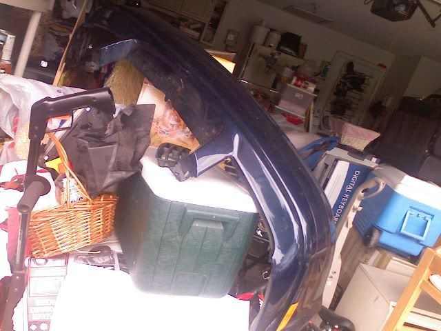

http://i21.photobucket.com/albums/b262/_dude_u_weirdo/kris%20pictures/bumper.jpg

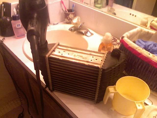

my intercooler is missing ::gasp::
http://i21.photobucket.com/albums/b262/_dude_u_weirdo/kris%20pictures/intercoolergone.jpg
There it is! And it found a hair drier!
http://i21.photobucket.com/albums/b262/_dude_u_weirdo/kris%20pictures/Intercooler.jpg
