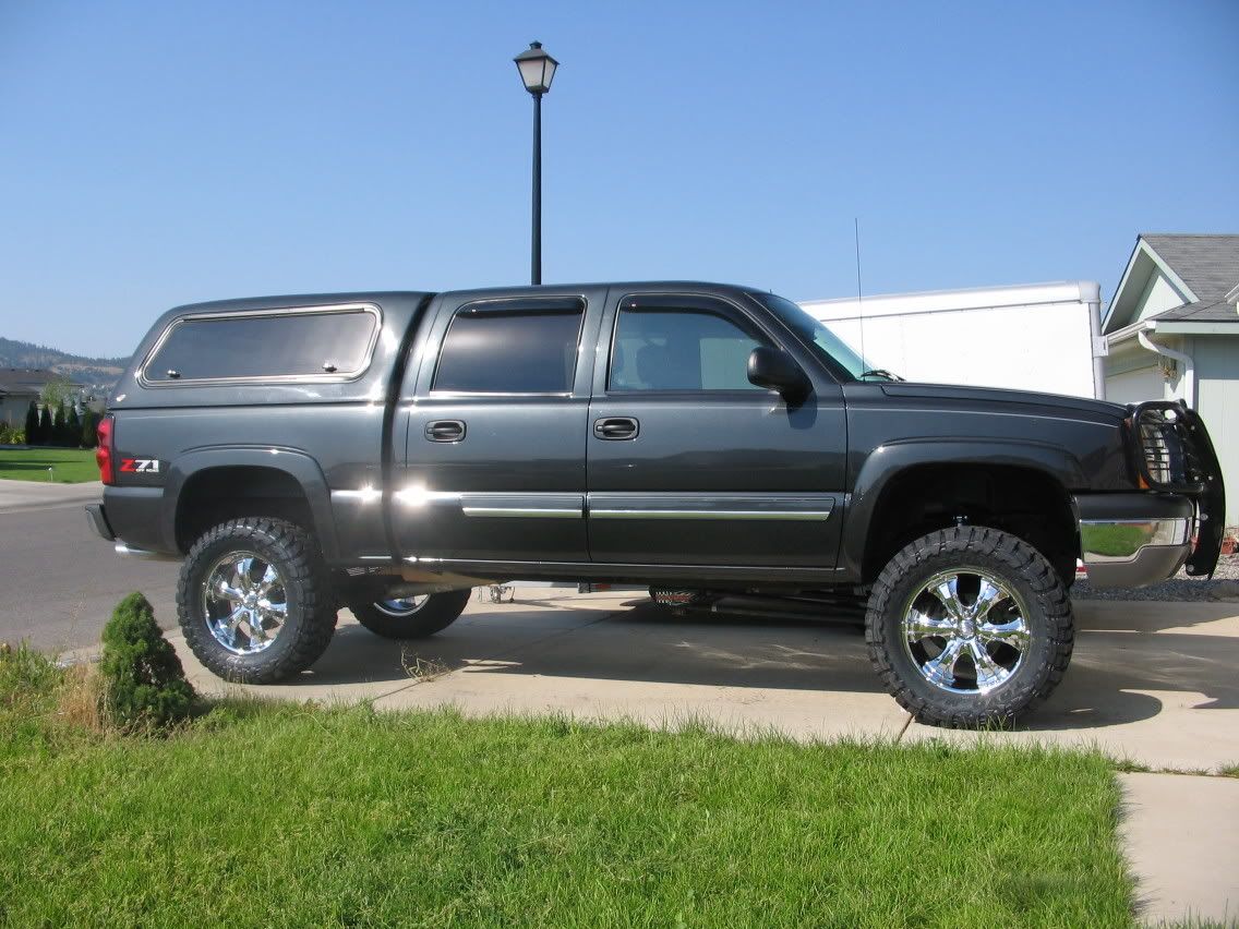

If your truck is a 4X4 3" body lift by itself will fit 35s on stock rims with a little crank and a little trim.
http://i89.photobucket.com/albums/k219/Oleg_Yakymovych/3157516BFGAT10.jpg
Buf if you go with aftermarket wheels you have to find some with similar backspacing or else you will have some major rubbing issues when turning. Thats the problem i had with my truck. To fix it i just got keys put in front and 4" block in the rear (stock block is 2" so 4" block gives 2" of lift). Right now i line up exactly with trucks that have a 6" suspension lift. Body lift cost me about 400$ and i installed it myself. Keys and blocks cost me 1200$ installed. Parts would only have been about 7-800? So in total i spent about 1600$ CAN. A 6" suspension lift here costs about $2900 - $3000 and the price for a 4" suspension lift is almost the same. If i wouldve started all over i probably just wouldve done the 6" suspension lift or i wouldve just added a 6" to my 3" BL and wouldve run 37s but i wouldnt be able to park in my garage. Keep in mind that 35s will cost you about 1200$.

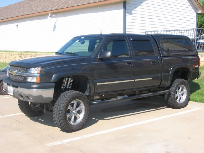

here is one with 8 inches of lift and 35's
http://i75.photobucket.com/albums/i289/bigbadram51/9f69dc8f.jpg
And 8" of susp. and 3" of body with 35's
http://i75.photobucket.com/albums/i289/bigbadram51/liftedsilvy008.jpg
