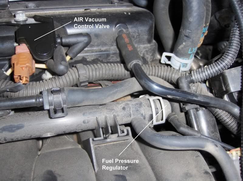

The thing that i am talking about looks like a regulator of some type,it has a fuel line connected to it, a electral connection on it,it also bolt to the intake manifold just behind the throtle body adapter on the firewall side of the engine. The FPR sets about 2 inches behind this thing on the fuel rail on the firewall side of engine. The fuel line that runs from this goes back toward the tank with the fuel supply line and the return from the fuel rails. If you want to post the picture of the air vacuum solenoid i sure would appricate it. Can't find a Haynes repair manual for this car any place. We bought the Cd that Chilton has but it wasn't much help.
LittleHoov
06-27-2007, 09:43 PM
The part youre describing sounds like the EGR valve, is it black? kinda....maybe a similar shape to a can, round on the sides, flatter on top. I think thats what youre describing, as thats the only thing in that area that has an electrical connection. That should have nothing to do with a fueling issue though.

Yes it is black and is round and it does have a flat place on it, i believe it is on the top. Is that a fuel line attached to it or a vacuum line. The sticker on the line says fuel for some reason. It probably is the EGR valve.

If you can't ID the part email me a picture.
http://i5.photobucket.com/albums/y158/kmohr3/intrigue_motor.jpg

The part that i was talking is in your picture,it sets just to the right of the FPR you can see the line that connect to it under i guess a breather pipe that comes from the valve pan cover. The vaccum line that connect to the FPR comes across this part at the bottom next to a fuel line connecting the fuel rails. Thank for the pictures,looks just like our engine. Hope we can get this engine to start. Went back out put scanner on it, it don't code anything, i guess that is what is making this hard to figure out.
kmohr3
06-28-2007, 07:16 PM
OK, I know exactly what part you are talking about. It's the EVAP cannister purge valve. It opens under certain conditions and lets the Evaporative Emmission Cannister vent (vapors) back into the intake. It's kind of buried in between the FPR and the EGR valve. It shouldn't have any bearing on why you're getting excess raw fuel dumped into your engine, though. It's #3 in the drawing below.

That is the part that i was talking about. Where is the EGR valve on this engine? We haven't been able to get pictures of anything on this engine. Can you think of anything else that might cause the raw fuel to get into the air intake besides the FPR. As it don't code anything when hooked to a code scanner. Thank for the pictures they are a big help.
LittleHoov
06-28-2007, 07:32 PM
The EGR valve is just to the left of the #3 part shown in the picture above. Its the somewhat canister looking thing that has the fuel line brackets wrapping around it.
