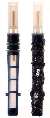

Based on my experiences with the Harrison V5/VDOT/TXV system a restricted orifice will show as low suction side pressure and lower than normal high side pressure so technically the pressure readings will not be normal. When the compressor kicks in, the suction against the restricted orifice will cause the compressor to quickly cycle out. After compressor disengagement, the rise in suction side pressure will usually be very slow. Rapid compressor disengagement and slow engagement may indicate a clogged orifice. A clogged orifice tube will starve a compressor of oil.
If you are getting excessive contaminants at the orifice tube then it may be signs of a compressor breaking down or failing usually caused by running with a low refrigerant charge in the first place. The contaminants are typically metal particles. Called the "Black Death." The pic below shows a contaminated/clogged orifice filter.
A/C repair shops will clean or change the orifice tube filter routinely as a matter of procedure but alot of times all the system needed was an evacuation and recharge to include the proper amount R134a refrigerant and compressor PAG oil.
http://i5.photobucket.com/albums/y186/lizzywiz/blackdeath.jpg
