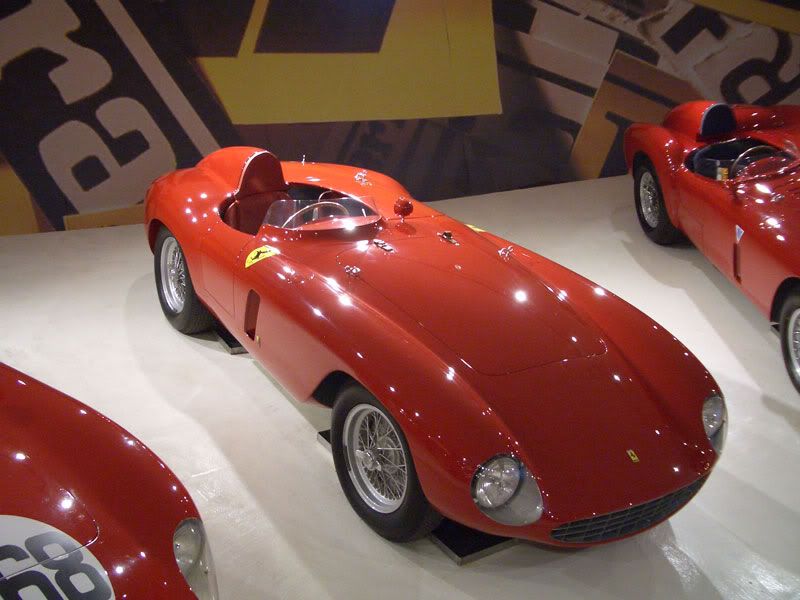

Indeed...Making anything even remotely close to original 750 Monza from this body will require a lot of work! The body is incorrect in so many places! Good luck with the build!

750 Monza, picts taken at maranello's gallery: Stevensky don't be narrow, pull out your picts ;) :D
