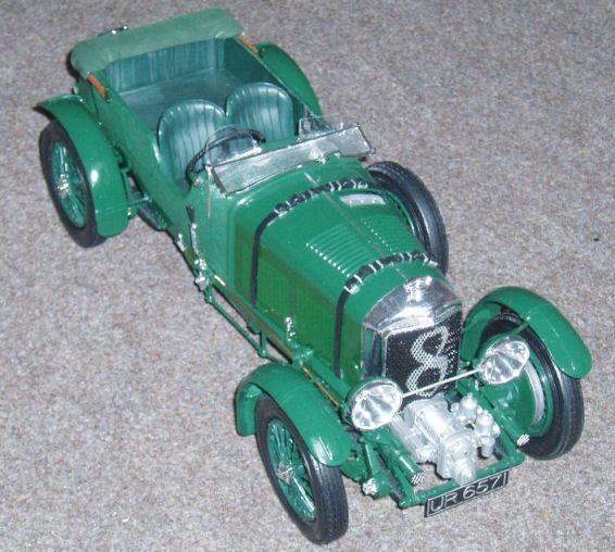

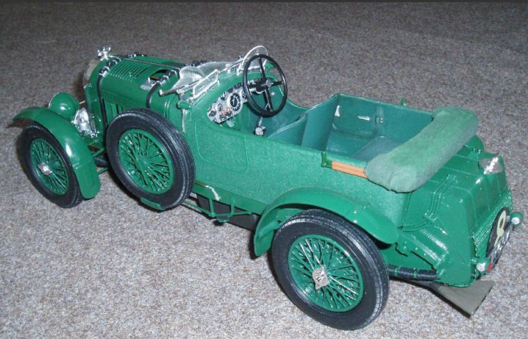

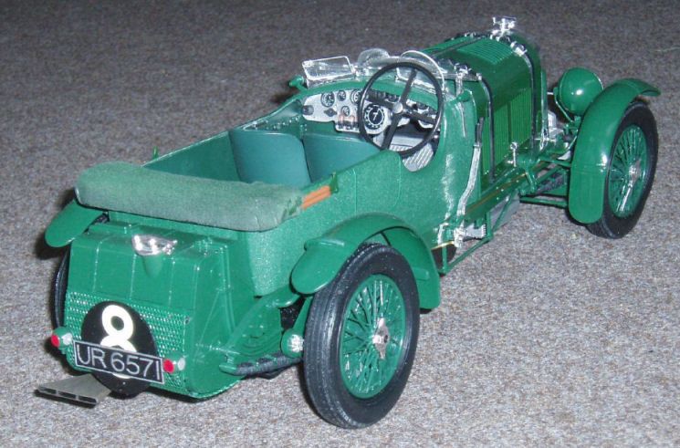

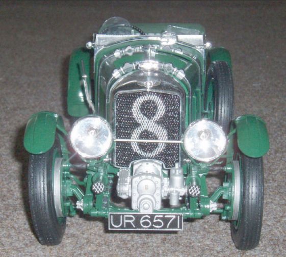

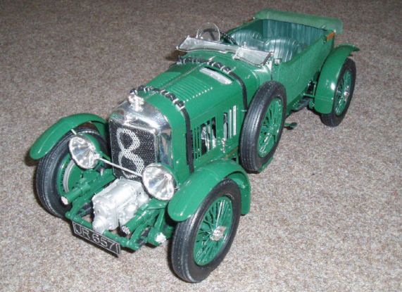

I found some pics of my Bentley:
http://foto.arcor-online.net/palb/alben/85/5480285/1280_3033376233653637.jpg
You can see the reworked stoneguards on the headlamps and the scratchbuilt stoneguard on the carbs. The tires have
a bad fit on the wheels.
Also note the difference between the glossy hood and the satin matte body.
http://foto.arcor-online.net/palb/alben/85/5480285/1280_6330346136376661.jpg
Next time I will respoke the wheels...
http://foto.arcor-online.net/palb/alben/85/5480285/1280_3435653435313766.jpg
Here is a shot of the engine with heat resitant covered spark plug cables and some extra wiring.
If you compare the 1/24 Heller kit of the Blower Bentley with the big Airfix kit there is not much difference in the details.
Have fun!
Uli

I built this kit around 5-6 years ago and I covered my body with satin fabric before spraying it green. It worked a treat.
I made templates in paper, cut out the fabric parts and sprayed the plastic body with permanent picture mount. The fabric was pressed in place, dried 48 hours and then the edges trimmed. Simple really.
I also replaced the mesh parts with real wire mesh and added loads of engine detail.
Regarding your engine probs - mine went together with no bother so I'm guessing you have something assembled incorrectly somewhere.
All the best, Roy.
