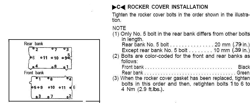

I remember reading somewhere here (but can't find it now) that when installing the valve cover there was a special way of doing it, right? Like you tighten all the bolts and then release some of them and then retighten everything again? Or was that some other part?

So umm....anyone know the answer to my question about the valve cover installation? -_-

^^Thanks Linebckr49.
