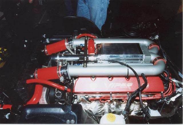

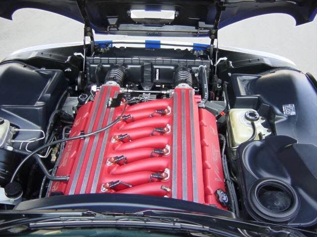

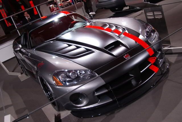

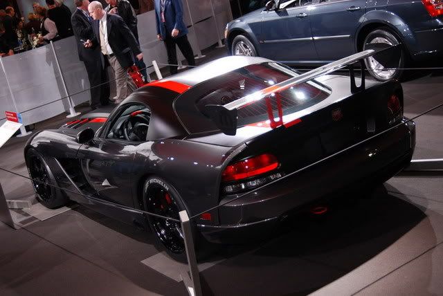

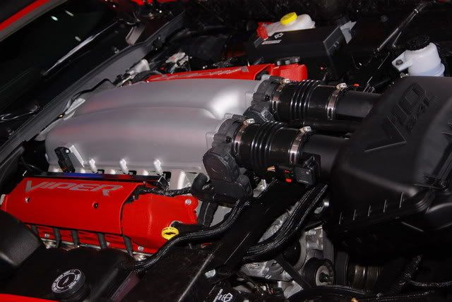

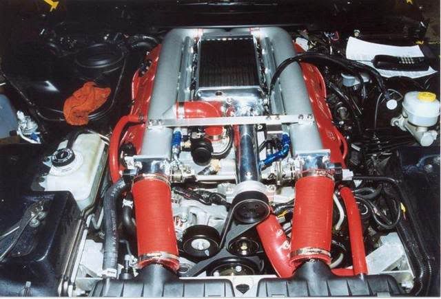

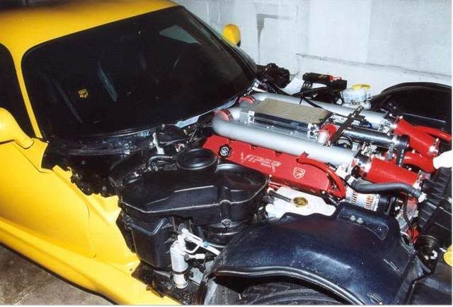

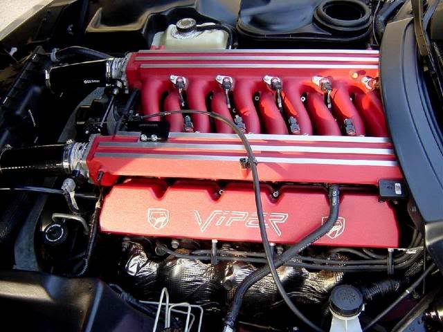

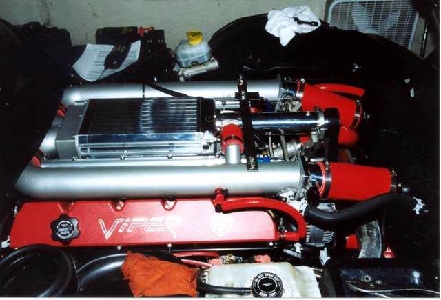

Hello all I'm still working on my Dodge sidewinder concept truck and had to look up images of the GTS-R engine and came up with this or these engine images if any one here needs to see thim. Now I still can't find where there the Distribr all I find is the front of the engine well hear they are:

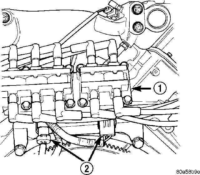

there isn't a distributor. But if memory serves me correctly the coil packs are on the back of the block

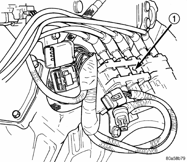

Viper and Dodge trucks with the V10 use a coil pack (well 2 actually a 4 cyl and a 6 cyl) Here are two pics from the service manual. The first pic you can see the flywheel, they are at the back of the engine and are right under the windshield cowl.
http://i42.photobucket.com/albums/e318/mikemechanic/vipercoils.gif
http://i42.photobucket.com/albums/e318/mikemechanic/vipercoils2.gif
Hope this helps
